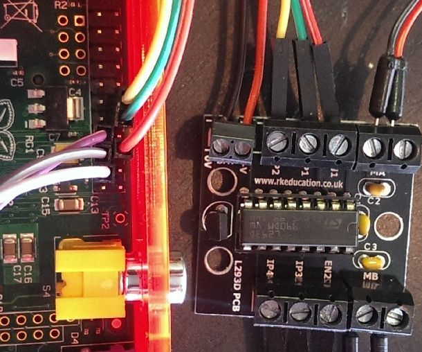

You can wire the motors, battery holder and wires to the L293D pcb as shown. The 9V battery will independently power the motors. The motors themselves are attached to terminals marked "MA" and "MB" on the board I have.
The other 3 pins (per side) are inputs 1 & 2 and an enabling terminal also. The enabling terminal could be regarded as a kind of handbrake, you have to enable the motor on the channel in order to drive it. The other 2 pins are switch controls which determine the direction the motor will spin.
Step 3: Connecting the Motor Driver Pcb to the RPi
Apparently you shouldn't connect anything to the GPIO pins while the RPi is running so it's worth making sure to heed this advice or it could be expensive.
You can connect the wiring to the RPi as shown in the image.
Don't put the 9V battery in just yet. I've found that if the battery is left in, it will slowly drain. Given that setting up the RPi for this could take some time, we'll just leave it out until we're ready for testing.
Another solution to this is that you can add a simple switch to the battery holder.
