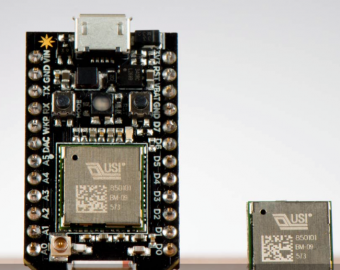

Particle (formally Spark) have released their new line of affordable WiFi enabled microcontroller platforms: The Photon. This is the successor to the Spark Core and measures in at a tiny 37mm x 21mm footprint. I have created a few garden watering devices using Raspberry Pi, Arduino, and Spark Core. This time I will create just a remote relay and enable it using IFTTT.
You must claim your Photon before using it. The process is so simple that Particle has create an iPhone and Android application for it.
