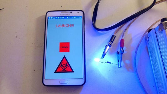

Step 4: Download the App and 3..2..1....LAUNCH
You can download the app from the google play store called Remote Rocket Launcher.
You can find the source code here. Fell free to build on it or make any changes.
Source code for the app will be available soon. You can use any app for arduino bluetooth as well. After you connect you just need to send l (Lowercase L) to the arduino to launch.
To test i used a LED with a 100ohm resistor instead on an igniter.
Enjoy.
