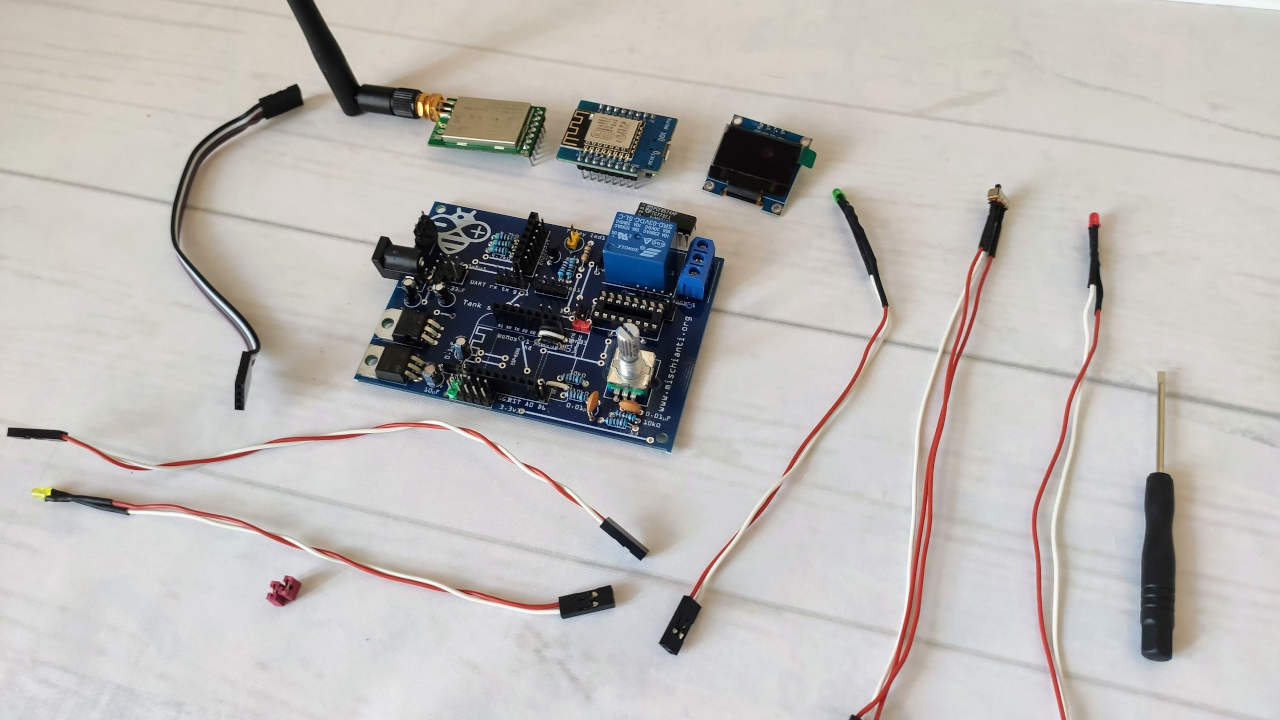

Step 4: Start Prototyping
To start prototyping, I use a series of shields created for this use, the result seems quite unstable, but It works very well.
WeMos All Shield pcf8574 ssd1036 relay e32 Lora
All this shield is distributed for free, and you can buy the PCB from the PCB producer, the complete PCB of the Server, and the client. It’s also available.
For the Server I use:
LoRa wireless remote water tank and pump controller esp8266 Server PCB
For the client
LoRa wireless remote water tank and pump controller esp8266 Client PCB
Step 5: Server PCB
LoRa wireless remote water tank and pump controller (esp8266) Server PCB explained.
Then, we must start to assemble the components, the LEDs, switch, display, WeMos D1, and EByte E32.
You can find the software here and the PCB and the instructions here.

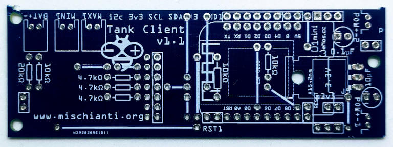

Step 6: Client PCB
For the client, I use the external module to manage the power supply, so there is no dependency for the people that don’t need to be autonomous with the battery.
Battery and Solar panel circuit
You can find all the components of solar battery recharge on “Emergency power bank homemade“.
LoRa wireless remote water tank and pump controller (esp8266) Client solar battery charge
Assembly
For assembly, you can refer to the silkscreen of the PCB, and I do It quite verbose.
LoRa wireless remote water tank and pump controller (esp8266) Client PCB up
Then, we must start to assemble the component, the LEDs, switch, display, WeMos D1, and EByte E32.

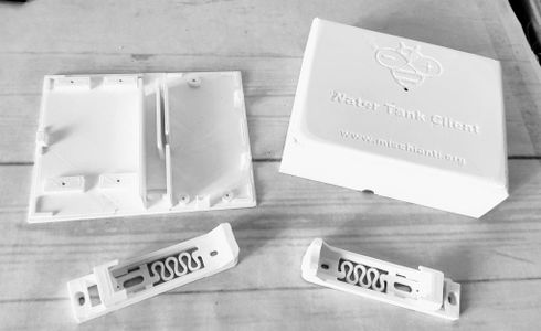

Step 7: Case for Server and Client
Step 8: Conclusion
And finally the assembled project.
