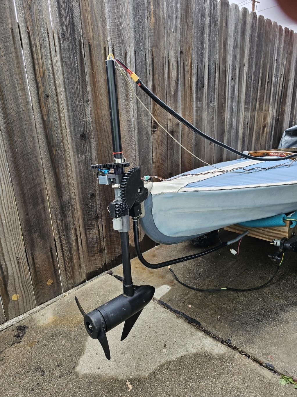

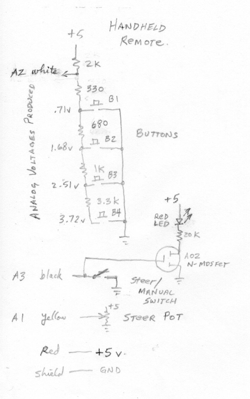

I made 3D printed trolling motor parts that replace all the stock transom mount parts that came with the motor. These parts fit the motor to the stern and fit where the rudder would go.Two small electric motors were added, one to tilt the motor, and one for electronic steering. My first design had a lift motor, but I found it easier to just pull the motor up via a cord. The tilt motor serves two purposes, to help pulling the motor up and to lock the motor in position either up or down. The tilt motor required a lot of thought; the motor needed just the right gear ratio to raise the heavy motor to the horizontal position. I 3D printed the gears in Nylon, the larger gear had to fit over the motor mount and be concentric with the mounting bolt. The smaller tilt gear attached to the motor had to climb up the larger gear during the tilting process. It took quite a while to get just the right gear thickness, stiffness, and alignment. The steering motor drive gear, shaft, and feedback gear use Nylon gears, although PLA+ works as well. An Arduino Pro Mini controls the 2 motors via separate H Bridges, located in the waterproof Pelican case. A handheld remote has a steering knob, 4 buttons for tilting and alignment, and a function select switch.
Because the trolling motor center of gravity about the motor shaft is toward the prop, when the motor is raised and tilted, the motor swings prop end down (see photo). This would present a problem when the motor is tilted back down, because then the motor faces backwards and the feedback pot aligns backward as well. A button on the handheld remote corrects the alignment via software when lowered back into the water. Note an accurate 360 degree feedback pot is needed so the software can calculate the offset to reset straight ahead and resume normal steering control. A button on the handheld controller moves the motor clockwise until the hall sensor detects the straight ahead position.

10k center detent potentiometer for steering (amazon)
knob, for steering potentiometer (amazon)
PCB mount pushbuttons (4 ea) (amazon)
assorted resistors for pushbuttons (amazon)

The key to this project was recognizing that the stock motor's mounting system and manual tilt would not work in this application. I tried fitting an adapter to the stock transom mount, but it was too bulky and wobbly. After I designed a new motor mount (motor shaft support tube and mount adapter) that fit directly to the stern of the kayak (where the rudder used to go) I could manually raise and steer the motor. I even had a pull cable to raise the motor. But that wasn't ideal, as I couldn't entirely tilt the motor out of the water. Thus, I decided to make this design with electric motors for raising, tilting, and steering.
The system works well.
