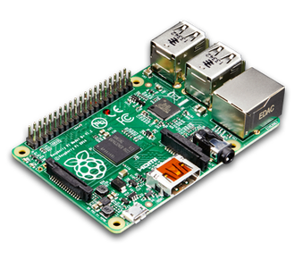

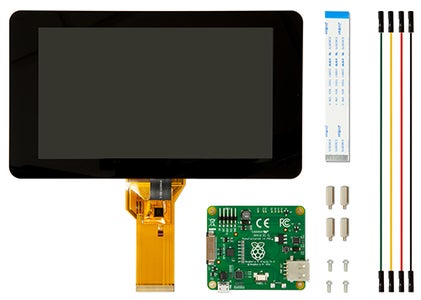

- a Raspberry Pi as a gateway with a 7 inches touch screen to display the received data.

- 1x Raspberry Pi
- 1x Official 7" touch screen

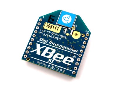

- 1x XBee module Serie 1

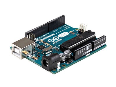

- 1x Arduino Uno
- 1x XBee modules Serie 1

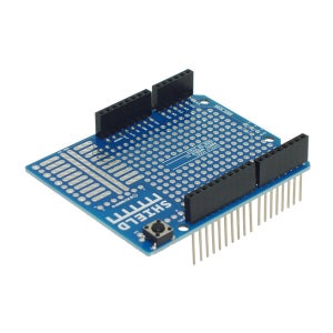

- 1x Arduino Uno proto shield with headers

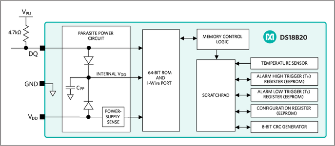

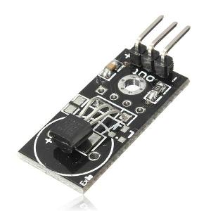

Step 3: Hardware: the Temperature Sensor
As seen before, the temperature sensor is based on an Arduino and 1-Wire temperature sensor.
1-Wire is a device communications bus system designed by Dallas Semiconductor Corp. that provides low-speed data, signaling, and power over a single signal. 1-Wire is similar in concept to I²C, but with lower data rates and longer range. It is typically used to communicate with small inexpensive devices such as digital thermometers and weather instruments. A network of 1-Wire devices with an associated master device is called a MicroLAN [Definition from Wikipedia]
The temperature sensor I choosen is the DS18S20 from Maxim. It has the follwing key features:
- Measures Temperatures from -55°C to +125°C (-67°F to +257°F)
- ±0.5°C Accuracy from -10°C to +85°C
- 9-Bit Resolution
- No External Components Required
As the XBee module works in 3.3V and the Arduino UNO in 5V, we will have to adjust the voltages levels for the serial interface between the XBee module and the Arduino

For the gateway there is no electronic to be made. The only thing to do is to assemble the touch screen and plug it on the Raspberry Pi. For this, check this good article: Raspberry Pi 7" touch screen assembly guide
Step 5: Software: Program the Sensor (Arduino)
Use Arduino IDE to program your Arduino.
Create a new Sketch with the code you can find on my GitHub

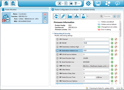

Step 8: XBee Modules Configuration
In order to be able to communicate, we have to create a XBee "network". So our modules must be configured.
The configuration is possible with the XCTU software
The XBee module used on the Gateway will be the coordinator. It's configuration MUST be:
- MY = 0
- ID = 3332
- AP = 1
- CE = 1 (Coordinator enabled)
The XBee module used for the sensor is en End Device. It MUST be configured as followed:
- MY = 2
- ID = 3332
- AP = 1
- CE = 0 (Coordinator disabled)
