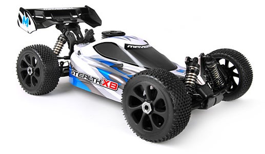

A few months ago I bought a rc car, a used one, very cheap. a maverick stealth xb or 4.6 hpi pulse (after the HPI bought Maverick).
I bought it without engine, but all the mechanics are very good, and also I have the remote (2ch) and receiver. I decide that the methanol engine is quite powerful but has a big disadvantage, has no reverse, so choosing the electric motor and trying to make the remote and the receiver by my self.

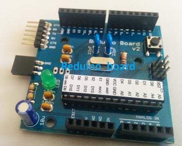

I used un arduino bard only to make the soft and to upload it to a board named "Reduino" :). Reduino comes as a DIY kit, and it's nothing but a ATMEGA 328 with arduino uno bootloader, external clock, the reset button, a power LED and pins all Arduino compatible

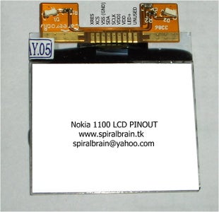

I had an old nokia lying around, and decided to use it. Normally you can use any display that matches the housing that you have / do. The Lcd may also connect with SPI or I2C (is also very used the lcd from nokia 3310 the LCD is very easy to use, there are some good libraries). if you choose the LCD Nokia 1100, I spent a few nights and made a library for this type of display (PCF8814). You can find the library here at the arduino forum or here at GitHub

Step 2: Prepareing the Lcd

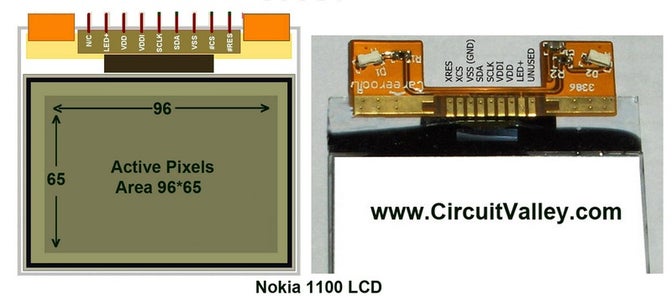

I played pretty much until I managed to use display. First time I used one of the nokia 3310 but I got to tear metal pins. with 3310 lcd was easy, there are a lot of libraries and bits of code that can be used. lcd 1100 we found only a simple library not having the graphics, then I tried to combine several libraries and after a few nights I managed to finish. I put the link in intro but go here. The driver for 1100 lcd is PCF8814 you can find the datasheet here.
To protect the display I decided to keep the metal housing and the clear plastic piece instead have used other LEDs.
I read quite well on this lcd and found different opinions about voltage on data pins (SPI), the datasheet says it's also ok 5v, but preventive I used some 10k resistors.
Connections SCLK (pin lcd 5) sdin (lcd pin 4), reset (lcd pin 2), SCE (lcd pin 1) is conected to 13, 11, 12, 10 on the Arduino through 10k resistors, the power is supplied by IC 7803 (3.3v) on lcd pins 6 and 7 + Lcd 3.3v and the pin 3 GND.
I fix the display with his metal cover on a PCB with 4 screws and in the top side(where the conections are made) the cables are fixed with another PCB piece and in the midle of the big PCB i put a sheet of metal that will fix the display on the remote case.

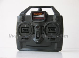

The original board of the remote had some simple contacts for stear and about 4 contacts to throttle
I cut where the screw starts to pull the shaft, then I drill the shaft on plastic side so we left with the pcb with carbon and the white plastic with the contacts
I fixed the plastic with a screw on the mobile part from the joystick. If the pcb is not moving easely on the joystick you can put a verry small nut between joystick and the white plastic.
The pcb must be glue on the remote housing.

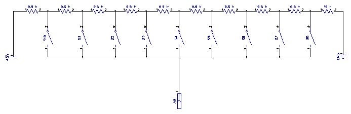

Step 4: Analog Key
For the meniu navigation i put 5 buttons, the actual switch are glued on the battery houseing and the plastic buttons are taped on top side of the remote.
The action keys(autopilot, headlight, reverse, divider) are puted on a small pcb with the led indicator and the rezistors.
The actual button(the plasticthat you push) are from some toys. You have to take care to the size of the holes you drill so the plastic button won't fall out.
The functional part is verry simple, every click take the +5v through 1, 2 ,3..... rezistors so you just need to read the analog value and compare, for a better and stable way i did something like this: Eg. key ok ....analogRead = 200...if analogRead <250 & >150 key = ok.

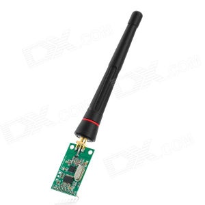

Step 6: Comunication
I chose a communications wireless module operating at 300-510 MHz. It is a serial transciver uses only two pins connected to the Arduino (rx, tx) and the the specifications shows that would work at 2000 meters, is included antenna, power supply is between 2.1 and 3.6 and is inexpensive. but like I said i don't have yet the module and I used wire for testing. This is the module "UTC-4432-B1 Long Distance Wireless Transceiver Module w/ Antenna", you can buy it from dx.com and they have there the full specification.
