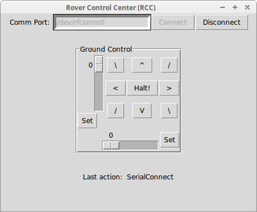

Step 13: Running the Python Control Application
To run the Python remote control application, download the zip file from this step and extract it to the location you want to run it from. Next, open a command shell (i.e. terminal, cmd.exe, etc...) and navigate to the directory you extracted the file to. Now type: python rover.py from the command line and a window looking like the one in the image should pop up. If not, look for any python errors and correct (i.e. missing libraries etc...) The Python site may help some if needed.
Once the App is running, you should be ready go.
Now, power on the bot. Then type the comm port of your adaptor and click the "Connect" button. After a few seconds you should see the other controls enabled and the connect button disabled. This means you are connected to the robot. If you can't connect to the bluetooth adaptor, you will have to use the magic of Google to help you out!
The control application is simple to use and allows for mouse or keyboard controls.
The keyboard controls are:
  • Arrows are forward, reverse, turn left 90 degrees, turn right 90 degrees
  • a - turn left 45 degrees
  • s - turn right 45 degrees
  • h - halt (stop)
  • y - set Gripper Y axis
  • u - set gripper open/close
  • c - gripper home
Forward and Reverse commands are constant i.e. they keep the bot moving after execution until a new direction is sent or a Halt command.
The turns 90 and 45 degrees are temporary i.e. After some delay, they stop the bot from moving.
The gripper sliders do not automatically set the gripper on the bot. You have to hit the corresponding "Set" button or key to do the actual execution of the set.
The Slider values range from 0-180.
  • Gripper Y Axis: 0 is All the way up and 180 is all the way down.
  • Gripper Open/Close: 0 is all the way closed and 180 and all the way open.
Use the "Disconnect" button to stop using the program. This will send commands to stop the bot and home the gripper.

Step 15: Code Listing for the Python Application
#!/usr/bin/env python
# For Linux, BSD or Mac OSX you can chmod +x on this script to make executable
# Rover control app
# Written by Scott Beasley - 2015
# Free to use or modify. Enjoy.
import sys
import serial
import time
from Tkinter import *
import tkFont
import tkMessageBox

        self.g_vert_fm.grid (row = 0, column = 0, rowspan = 4, sticky = W)
        self.leftforwardButton = Button (self.f2, text = "\\",
                                 command = self.TurnLeft45,
                                 name = "b_left_forward")
        self.leftforwardButton.grid (row = 0, column = 1)
        self.master.bind ("<a rel="nofollow">", self.TurnLeft45)
        self.leftButton = Button (self.f2, text = "<",
                                 command = self.TurnLeft, name = "b_left")
        self.leftButton.grid (row = 1, column = 1)
        self.master.bind ("</a><a rel="nofollow">", self.TurnLeft)
        self.rightforwardButton = Button (self.f2, text = "/",
                                 command = self.TurnRight45,
                                 name = "b_right_forward")
        self.rightforwardButton.grid (row = 0, column = 3)
        self.master.bind ("</a><a rel="nofollow">", self.TurnRight45)
        self.haltButton = Button (self.f2, text = "Halt!",
                                 command = self.Halt, name = "b_halt")
        self.haltButton.grid (row = 1, column = 2)
        self.master.bind ("</a><a rel="nofollow">", self.Halt)
        self.rightButton = Button (self.f2, text=">",
                                  command = self.TurnRight, name = "b_right")
        self.rightButton.grid(row = 1, column = 3)
        self.master.bind ("</a><a rel="nofollow">", self.TurnRight)
        self.upButton = Button (self.f2, text="^",
                               command=self.Forward, name = "b_forward")
        self.upButton.grid (row = 0, column = 2)
        self.master.bind ("</a><a rel="nofollow">", self.Forward)
        self.leftdownButton = Button (self.f2, text = "/",
                                      name = "b_left_down")
        self.leftdownButton.grid (row = 2, column = 1)
        self.downButton = Button (self.f2, text="V",
                                  command=self.Reverse, name = "b_reverse")
        self.downButton.grid (row=2, column = 2)
        self.master.bind ("</a><a rel="nofollow">", self.Reverse)
        self.f2.grid (row = 1, column = 0, pady = 25)
        self.rightdownButton = Button (self.f2, text = "\\",
                                       name = "b_right_down")
        self.rightdownButton.grid (row = 2, column = 3)
        self.g_horz_fm = Frame (self.f2)
        self.grip_horz = Scale (self.g_horz_fm, from_ = 0, to = 180,
                                orient = HORIZONTAL)
        self.grip_horz.grid (row = 0, column = 0, columnspan = 7, sticky = E)
        self.grip_horz_set = Button (self.g_horz_fm, text = "Set",
                                     command = self.GripperX,
                                     name = "b_grip_horz_set",
                                     width = 1, height = 2,
                                     font = helv6)
        self.grip_horz_set.grid (row = 0, column = 8)
        self.master.bind ("<u>", self.GripperX)
        self.g_horz_fm.grid (row = 4, column = 0, columnspan = 7, sticky = E)
        self.master.bind ("</u></a><a rel="nofollow"><u>", self.GripperHome)
        self.f3 = Frame (self.frame)
        self.l2 = Label (self.f3, text = "Last action: ")
        self.l2.pack (side = LEFT)
        self.l3 = Label (self.f3, text=" ", textvariable = self.message)
        self.l3.pack (side = RIGHT)
        self.f3.grid (row = 3, column = 0, pady = 8)
    # Set the state of the bot control buttons. Enable when connected,
    # Disabled otherwise.
    def CtrlButtonsState (self, bstate):
        self.leftforwardButton.config (state = bstate)
        self.leftButton.config (state = bstate)
        self.rightforwardButton.config (state = bstate)
        self.rightButton.config (state = bstate)
        self.upButton.config (state = bstate)
        self.leftdownButton.config (state = bstate)
        self.downButton.config (state = bstate)
        self.rightdownButton.config (state = bstate)
        self.haltButton.config (state = bstate)
        self.disconnectButton.config (state = bstate)
        self.grip_horz.config (state = bstate)
        self.grip_vert.config (state = bstate)
        self.grip_horz_set.config (state = bstate)
        self.grip_vert_set.config (state = bstate)
    # Set the state of the comm port entry. Enable when not connected,
    # Disabled when the bot is connected.
    def ConnCtrlsState (self, bstate):
        self.connectButton.config (state = bstate)
        self.comm_entry.config (state = bstate)
    # Connect to the comm port typed in the comm entry field.
    def SerialConnect (self):
        try:
            # Change the baud rate here if diffrent then 57600
            self.ser = serial.Serial (self.comm_entry.get ( ), 57600)
        except IOError:
            tkMessageBox.showerror ("Invalid comm port", "Comm port not found.")
            return
        self.ConnCtrlsState (DISABLED)
        self.CtrlButtonsState (NORMAL)
        self.message.set ("SerialConnect")
        self.connected = True
        time.sleep (3) # Dwell a bit for the connection to happen
    # Disconnect from the bot (close the comm port).
    def SerialDisconnect (self):
        try:
            # Send a Halt command just in case the bot is still moving.
            self.send_cmd ('h', "Halt!")
            time.sleep (1)
            self.ser.close ( )
        except IOError:
            print "Could not close port..."
        self.message.set ("SerialDisconnect")
        self.ConnCtrlsState (NORMAL)
        self.CtrlButtonsState (DISABLED)
        self.connected = False
        time.sleep (2) # Dwell a bit for the disconnection to happen
    # Send the command to the open comm port
    def send_cmd (self, action, msg):
        if self.connected == True:
            for val in action:
                self.ser.write (val)
            self.ser.flush ( )
            self.message.set (msg)
    # Send the bot a turn-left command.
    def TurnLeft (self, event = None):
        self.send_cmd ('a', "Left")
    # Send the bot a turn-left-up command.
    def TurnLeft45 (self, event = None):
        self.send_cmd ('q', "Left45")
    # Send the bot a turn-right command.
    def TurnRight (self, event = None):
        self.send_cmd ('s', "Right")
    # Send the bot a turn-right-up command.
    def TurnRight45 (self, event = None):
        self.send_cmd ('e', "Right45")
    # Send the bot a Forward command.
    def Forward (self, event = None):
        self.send_cmd ('w', "Up")
    # Send the bot a Reverse command.
    def Reverse (self, event = None):
        self.send_cmd ('z', "Down")
    # Send the bot a Halt command.
    def Halt (self, event = None):
    # Set the gripper (X).
    def GripperX (self, event = None):
        # Read the slider control and send the value to the bot controller
        # Note: 0 is all the way closed and 180 is all the way open
        grp_change = ('>', chr (self.grip_horz.get ( )), chr (255))
        self.send_cmd (grp_change, "Gripper X")
    # Set the gripper Y.
    def GripperY (self, event = None):
        # Note: 0 is all the way up and 180 is all the way down
        grp_change = ('^', chr (self.grip_vert.get ( )), chr (255))
        self.send_cmd (grp_change, "Gripper Y")
    # Set the gripper to the "home" position.
    def GripperHome (self, event = None):
        self.send_cmd (('c', chr (255)), "Gripper Home")
    def __init__ (self, master = None):
        Frame.__init__ (self, master)
        self.pack ( )
        self.createWidgets ( )
# Kick off the GUI (Tk) then size and title the app window
def main ( ):
    root = Tk ( )
    root.geometry ("450x350")
    root.wm_title ("Rover Control Center (RCC)")
    app = App (master = root)
    app.mainloop ( )
if __name__ == '__main__':
    main ( )
