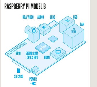

Step 1: What You'll Need
Nothing special is required for this ible, but you must have theese:
- Raspberry Pi model (A, A+, B, B+, Bv2)
- Internet Connection
- Power supply for the Pi
- SD card with Raspbian OS
- Lan cable or WIFI dongle
- Putty or another program that allow you connect to the Pi throug SSH (it's preferable use SSH)

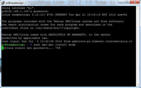

Step 2: Install Xrdp
When the Pi is on you can access to the CLI using Putty. Now you can proceed to perform this command:
sudo apt-get install xrdp

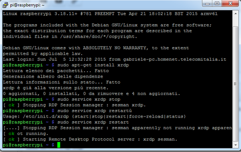

When the installations process it's over you have to stop xrdp and then restart it. You can do this using these commands:
sudo service xrdp stop
sudo service xrdp restart
Jump to the next step, we are close to the end ;D
