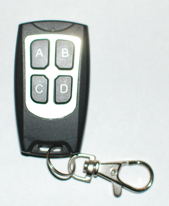

- Keyfob Remote Control http://www.adafruit.com/products/1095

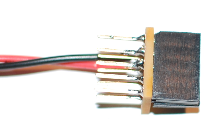

Cut a small piece from the perf-board like the one in the second photograph.
Cut two pieces of the female stacking headers, one with 5 pins, and one with 4 pins. leave enough extra so you can sand the ends smooth.
Solder the 5 pin header into the five holes on the right in picture two. As the male pins point up.
Solder the 4 pin header into the middle holes, use the bottom 4 holes leaving the top one open.
Cut 2 pieces of the 22 guage hookup wire, 1red, 1black, long enough to reach out of the case to where you are going to want the receiver to sit.
Solder the red wire into the middle left hole, and the black wire into the next hole up.
Twist the wires together loosely.

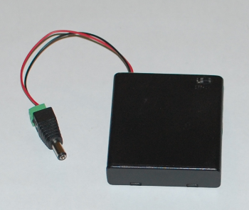

Connect the wires from the battery box to the DC Barrel Jack Adapter.
You can use a plug in power supply, like this, instead of the battery pack if you want to.
Any 5-6 volt power source will work.

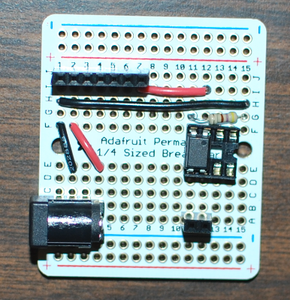

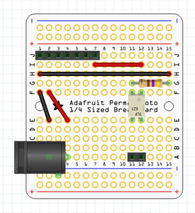

The first part to solder is the 2.1mm barrel jack. Solder the barrel jack into holes A-2 , A-4, and hole number 3 in the ground rail.
Cut two pieces of the female stacking headers, one with 7 pins, and one with 2 pins. leave enough extra so you can sand the ends smooth.
Solder the headers like in the first photo.
The 8 pin IC socket is not shown in the illustration, it should be soldered into holes E11-14 and F11-14. The alignment notch should be pointing to the right.
Solder the resistor and the wires as shown in the illustration to finish the receiver.
Plug the optoisolator into the left side of the socket with the alignment dot pointing to the right.

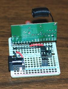

Plug the radio receiver into the 7 pin header, like in the third photograph.

Plug in the battery and press any button on the remote to turn on your computer.
