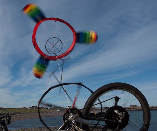

I built this in my quest to open source airborne wind energy. (Making power with kites has become efficient)
A steered single line lifter was needed for my daisy power project, but
It also helps in Kite Aerial Photography when framing is everything and you want your kite held to one side,
It can help penguin toys realise their dreams and fly... Well that's what my kids wanted it for... So many practical uses.
