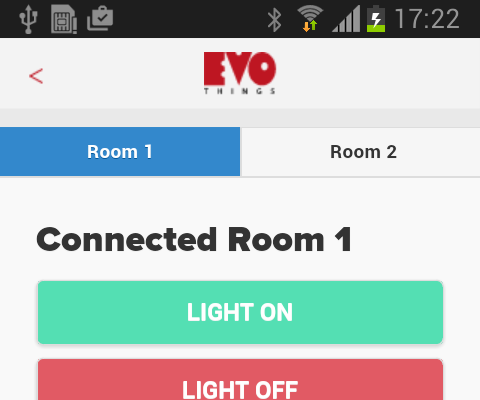

So, in this case, following code bit is doing all the work. When a user presses the "LED ON" button, the script will write "a" onto the Arduino serial using BluetoothSerial plugin and in the other case it will write the character "b", which our Arduino sketch understands as the argument to switch the LED to off status.
app.initialize(); app.ledOn = function(){ bluetoothSerial.write("a"); } app.ledOff = function() bluetoothSerial.write("b"); }

Step 8: Reviewing the Completed Bluetooth Remote Control App
So, now we have our app and hardware working. Your app is already running in Evothings client, that is great, you have your 3 buttons and they switch the lights on and off and also let your manage your connection with the bluetooth module. Play with these, your work is over. The next step will be to Google a tutorial about adding a relay instead of the LED and control your home's lights through your new remote control.
