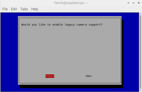

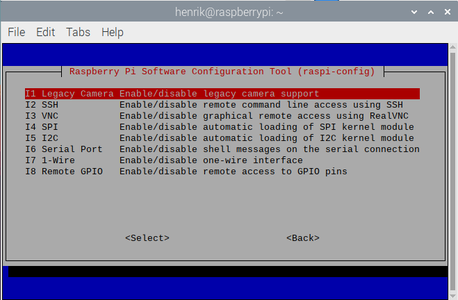

Step 3: Enable Camera
Open a terminal and enter the following command:
sudo raspi-config
This opens up the control panel of the pi.
Go to interface options and click enter.
Choose legacy camera and click enter.
Use arrow keys to move cursor to yes and click enter.
This will prompt you to restart your pi, the changes will not take effect until you do that.

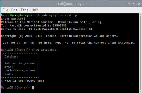

Now we will create a database and in that database we will create a table. In that table we will create a single entry with 6 columns. You might think is is unnecessary to use a database for just one row but it's not always about the goal, it's about learning SQL which is a really good thing to know, I've been told.
In a terminal enter:
sudo mysql -u root -p
This will prompt you for a password. Remember the one we just created? It's that one.
Now you will be able to create and alter databases. Start with enter the command
show databases;
This will show you the existing databases, as you can see I already have one called plant but you probably don't just yet.

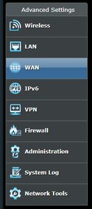

Step 9: Making It Available Outside Your Local Network
This part is a bit on your own risk, I am not really good at network security so the code contains little to no security measures (more no than little). I am not in any position to tell you about what a potentially malicious person may do to your computer or your network but at least now you have been warned.
Go to your router login page, for Netgear router that is 192.168.1.1 and login. If you don't know your credentials, try admin as username and admin as password, I think that is default for most routers.
Now there are better guides out there on how to do this on all the possible brands of routers but I'll walk you through how to do it on a netgear router.
When you log in you are met with a summary page of your network. In the left most panel, there is a button labeled WAN which you will press. Now in the top panel, go to Port Forwarding and the press Add profile.
Everything you need to alter is the external port which should be set to 80 (80 is apparently the defaul port for apache servers) and Internal IP adress should be your pi:s IP adress. Again if you do not know this go to a terminal and type in:
ifconfig
and scroll through until you find it, it is on the second line of the third chunk of text.
The field Service name is only the name of you application, mine is called plant and this makes it easier to keep track och which ports are opened by what reason later on.
