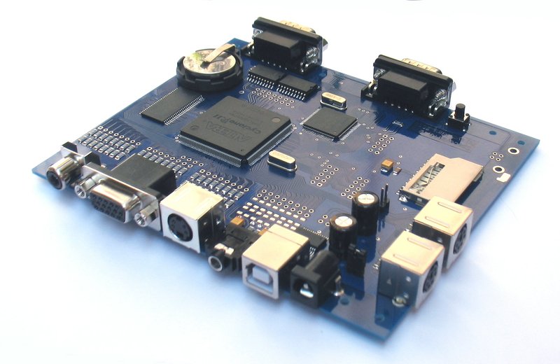

Step 2: Remotely Controlled VGA Camera - PCB Design
Using PCB tool (http://pcb.geda-project.org) design PCB layouts for both boards. We route them manually to achieve best possible results and taking into account technological capabilities of a PCB manufacturer. An inexpensive Chinese fabrication house Pcbart has been picked up, its capabilities for 'standard PCBs' might be found at http://www.pcbcart.com/cart.php?page=capability___standard_pcb. To bring overall cost down we design two layer boards.
After submitting Gerber files for both PCBs in two weeks our boards are finally delivered. At the same time ordering electronic components in accordance with BOM files so that upon PCBs arrival we will be able to start soldering straight away.

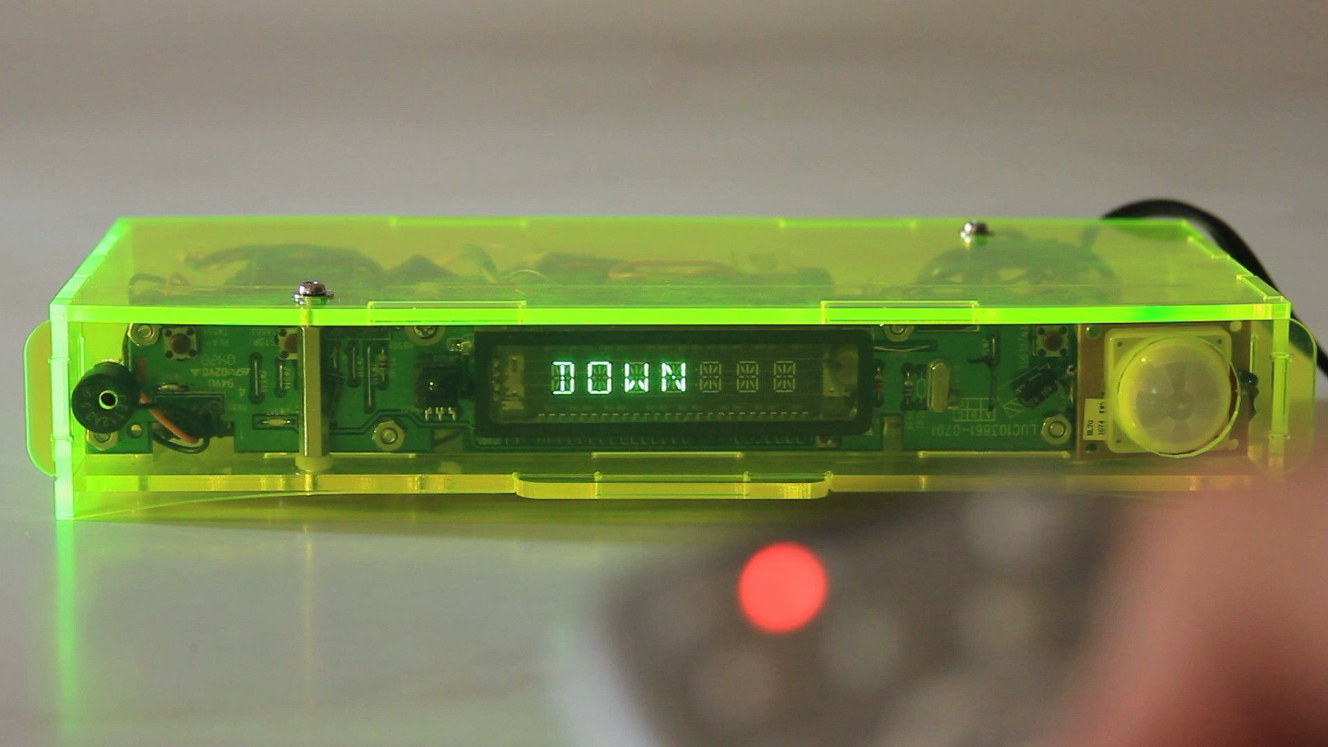

Step 9: Remotely Controlled VGA Camera - Putting Everything Together
Final touches - adding 3.3V LCD from SparkFun (http://www.sparkfun.com/products/9052) and IR receiver (http://www.sparkfun.com/products/8554).
As a result - the system may be controlled from distance by a RC from TV/DVD. LCD plays significant role in diagnostics when you don't have PC/notebook connected to USB port.
