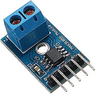

My solution was to use a MAX31855 K-type module to read my furnace's K-Type Thermocouple, instead of the furnace thermometer/display. I then used a Raspberry PI to read the temperature from the MAX31855. I then installed a web server on the Raspberry PI (Apache) and instructed the webserver to display the furnace temp. Now all I do is point any browser to the Raspberry PI to see the value. I can use my laptop, my phone, even my smart TV! I then set my router to forward to my PI so I can access the live values from anywhere.
1 x Max31855 k-type module
1 x Raspberry PI (I used a model 3)

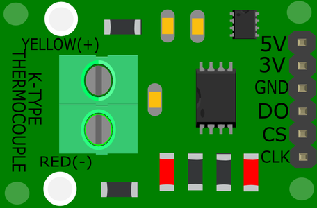

Step 2: Connecting the MAX31855 Module to the PI
I'm going to be using Tuckies Max31855 python project on Github that works great. https://github.com/Tuckie/max31855.
The Github code has the following pin assignments in the readme.md: GPID 22 = DO, GPIO = CLK, GPIO = CS.
Also, we will be using the 5V and Ground, not the 3.3V (Only connect the 3V if your circuit doesn't have a 5V, mine had a 5V to 3V converter built-in.)
Next, connect the thermocouple to the terminal block. In my case, I had a spare K-type that came with the module, so testing was simple. If you don't have that, you will need to directly connect to the furnace probe.
