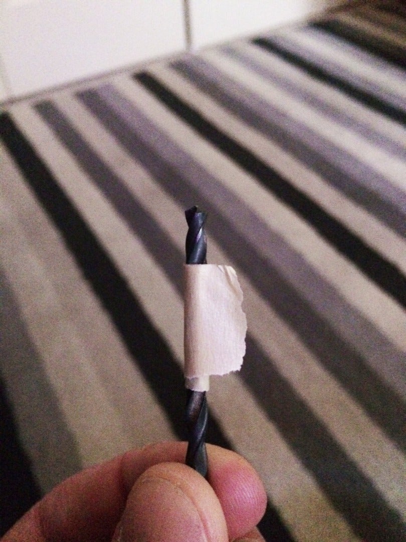

  5. Now that you have your drill guides, prep your drill-bit to make pilot-holes for your screws:
    • Using a piece of masking tape, mark off the depth on your drill-bit, so to avoid drilling through the surface
    • Drill pilot-holes for your screws
