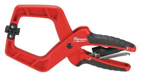

Required Tools:
- Milwaukee Tools Stop Lock Hand Clamp (http://bit.ly/29J4nKT)
- C-Clamp
- Bolt
- 2X Custom Winder Head (http://bit.ly/29NsV7P)
Step 2: Assembling the Stator Winder Clamp
Remove the standard headers on the Stop Lock Hand Clamp and replace with the Custom Winder Heads to create the Stator Winder Clamp.

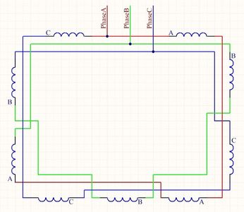

Step 10: Solder Wires
Solder the individually wound poles according to the diagram shown in the photo.
