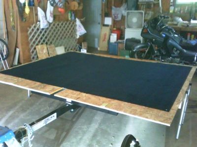

Step 6: The Deck, Adding Carpet.
For comfort purposes, I bought some outdoor carpet. Installed snaps to the blandex and the carpet so it can be removed and rolled up for storage when not in use or winter storage.

Step 8: The Result
This is the end result. With some basic carpentry skills and very cheap material you can improve your camping experiance.
