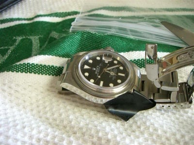

Being very careful, press the tip of your knife into the crack between the case and the bezel. You need to insert it just enough for it to grab the bezel. Then pry the bezel straight up, prying against the tape covered lug. It doesn't take a ton of effort.

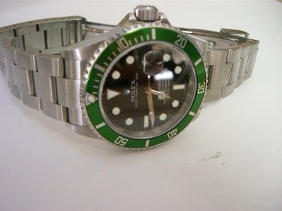

First pic shows the watch just after the pop, second with the bezel removed.

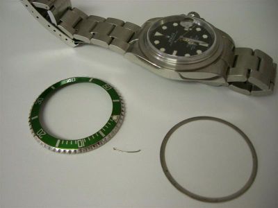

Here's a pic of the spring that allows the bezel to click when you turn the bezel. It's not a coiled spring, but a straight spring. It's shaped like an L with a curve on the long part that has the same curve as arc of the watch face. It's a horrible thing to lose this spring. You'll also see that there is a lower ring still on the watch in the first picture. The second picture shows all the parts separated.

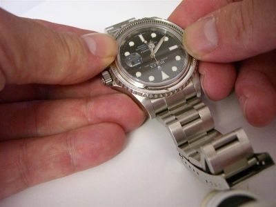

The bezel is really 2 pieces (first (blurry) pic), the bezel, and the insert (green). The insert is made of anodized aluminum. It's pretty easy to pop out. From the back of the bezel grasp it like I'm doing in picture 2. Apply even force with your 2 fingers until it pops out of the bezel. 3rd pic is of all 4 parts. If you want to take it apart any more, you're on your own.

To reinstall the bezel, first place the inner ring on the watch. Then carefully insert the spring in the hole in the case and gently tuck the long part of the L into the slot along the raised round part of the watch. I'll reuse a previous picture to show you what I mean. Now take the bezel (insert still removed) and line it up with the case, starting at the spring. You'll then apply even pressure with both of your fingers as you work your way around the bezel (pic 2). Ultimately your fingers will meet opposite the spring, and if you're pressing hard enough you'll hear a distinct click as it snaps back into place. Don't be afraid to use some pressure, that stainless is strong. Gold watches will require the same pressure, but you'll want to be a touch more careful because the gold is pretty soft. Make sure you hear the click. You don't want your bezel popping off and falling through the subway platform on your way to work.
Once it snaps into place, you can rotate it and make sure everything is working properly.
