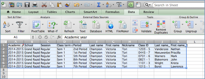

Step 1: Highlight All Data to Be De-duplicated

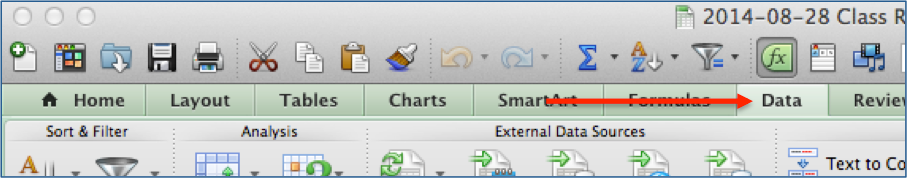

Step 2: Click the Data Tab

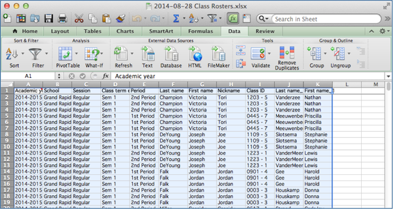

Step 3: Click the Remove Duplicates Icon

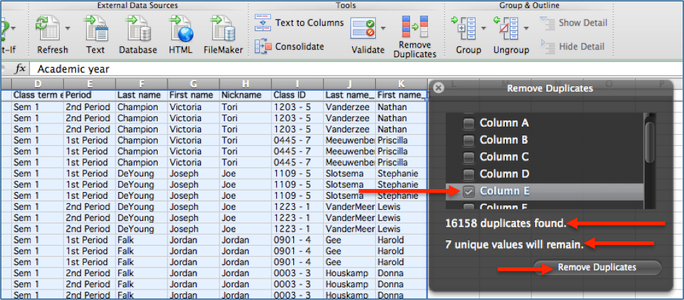

Step 4: ​In the Remove Duplicates Window:
  1. choose the column(s) you wish to remove the duplicates from (example shown: Column E—Period)
  2. at the bottom of the column listing, the number of duplicates found and remaining number of unique values is displayed.
  3. click the Remove Duplicates button

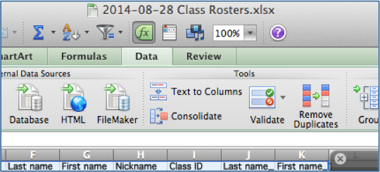

Step 5: Back at Your Spreadsheet, You Should Find Your Data With All the Duplicates Removed
