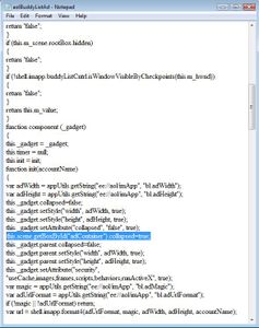

C:\Program Files\AIM6\services\imApp\your_version\content\bl\aolBuddyListAd.js
"your_version" is your current version of AIM, not the name of a folder =)
hit CTRL + F and search for "adcontainer" and change "collapsed=false" to "collapsed=true" .
Save the file.

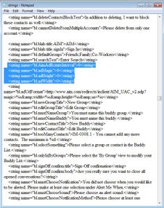

C:\Program Files\AIM6\services\imApp\your_version\resources\en-US\strings.xml
remember the note from the previous step about "your_version"
hit CTRL + F and search for "AimAdRotateInterval"
Change the values that are there for these four lines to zeros so they look like this"
<string name="bl.AimAdRotateInterval">0</string>
<string name="bl.adMagic">0</string>
<string name="bl.adHeight">0</string>
<string name="bl.adWidth">0</string>
Save the file, exit Notepad... start AIM.. and enjoy your ad-less buddy list!
