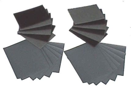

1200 grit wet dry sand paper

First, take a piece of your 1200 grit and cut it into a small square about the size of the pad of your finger. Get it wet with water and then locate the scratch on the face of your iphone. Begin sanding off the scratch.
The reason I call this the danger zone is because of something that can happen to glass when you sand it called lensing. It will create a slight concave in the glass which effectively does the same thing as glasses do for your eyes. It bends the light. However, the screen is not out of focus so this is bad bad bad. To remedy this, go slowly. Make longer strokes and use moderate pressure. Let the sand paper do its job. You don't want to dig out the scratch.
Keep the area wet. Do not worry about water getting into the iphone, there is a rubber gasket around the edge of the screen. However, you want to keep water away from the home button and the speaker. This isn't difficult as water sticks together so it doesn't move a lot. Don't soak the phone, just enough to get the sand paper moving.
Place the square of sand paper over the scratch and just press with the pad of your finger and sand as you would wood (all in the same line.) As you sand, the glass that gets sanded off will make a bit of a paste with the water. As long as it is runny, it is fine. Let it get too thick and you will get nowhere. Keep the sanding area runny.
Keep looking for the scratch, and feeling it with your fingernail. After a while you wont be able to feel it, but you can still see it. Keep going until it is "nearly" gone. Go all the way and you risk lensing the glass.
Once you are done, you should have a very visible scuff on your phone. It should only take about 10 minutes to get to this place even if you are really slow. The 1600 grit is nice to use if you want it. It reduces the amount of polishing time dramatically, but I would only use it if you are polishing with a rag. Sand the area the same as before with the 1600 grit. But instead of sanding away a scratch, sand until it feels like you are sanding a smooth surface (about 5 min.)
