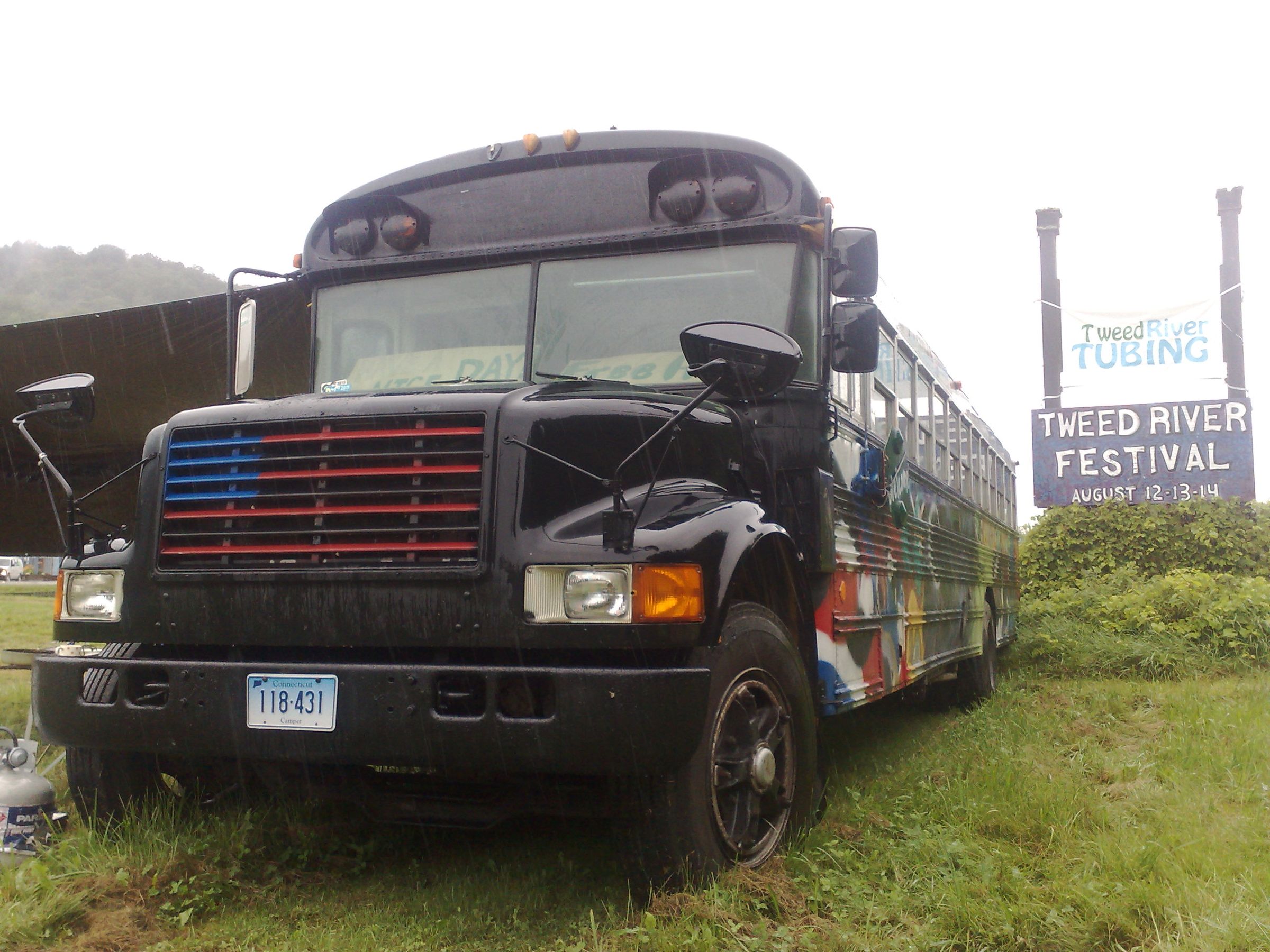

Some friends and I are converting a school bus into an RV/Roadtripmobile to take across the country next summer. This summer, we're going to be doing a lot of work getting the bus (and ourselves) ready for the trip. This is something I've wanted to do for a long time, and while there are some well documented bus conversion projects online, they never quite gave me what I wanted.
So my goal with this is to address everything I had wondered about before I got my bus, and detail it simply and clearly online (both here and at our website: juanway.org). There will be more at all major stages including installing bunks, benches, basic plumbing, and getting the bus to run on veggie oil. But we're not there yet. This one is about the first major obstacle - removing the seats.

Many sites recommend an angle grinder, to just pop the bolts off, and as far as I have seen that works, but if you have the man power, the ratchet/wrench combo is pretty easy, and several people can work at once. Also, more people are likely to have those than an angle grinder.

Lastly, bolts will break. This bus is 18 years old, and the bolts are pretty rusty. They will break, but it usually doesn't matter, as you can still get the seats out. Less work for you!
