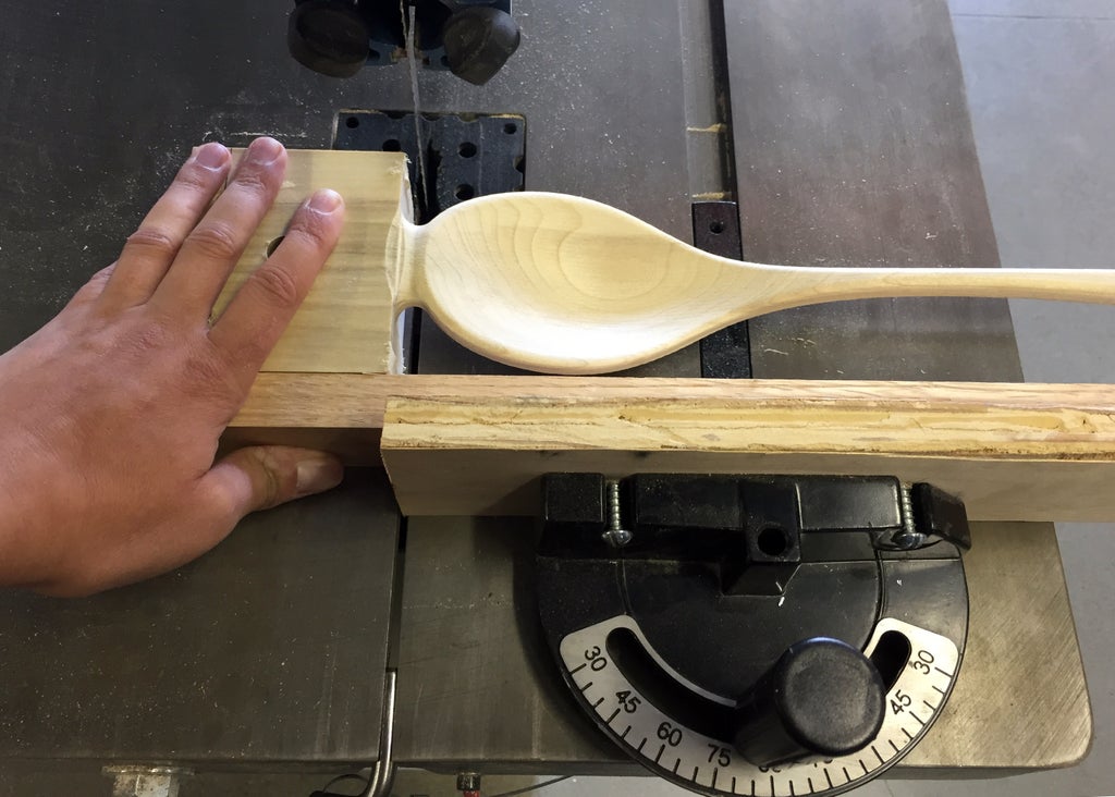

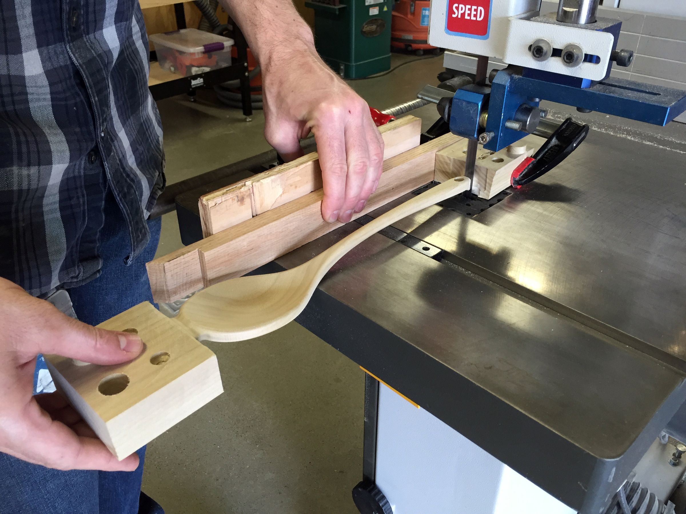

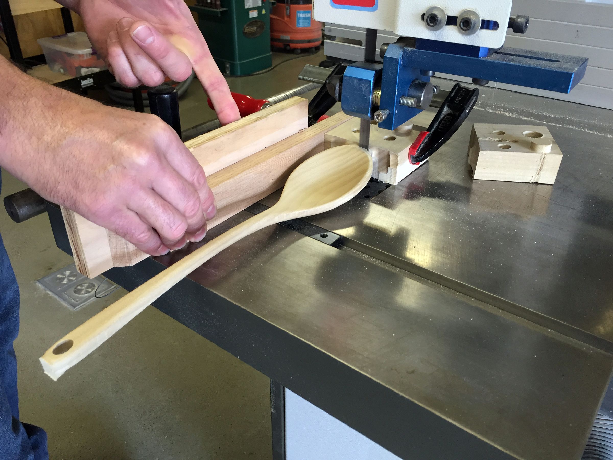

1) Bring your part into the wood shop, and place the miter on the vertical bandsaw.
2) Take a scrap piece of rectangular stock and place it in front of the miter, so that the front rectangular prism of the spoon is resting against it.
3) Clamp the scrap to the rectangular prism on the spoon.

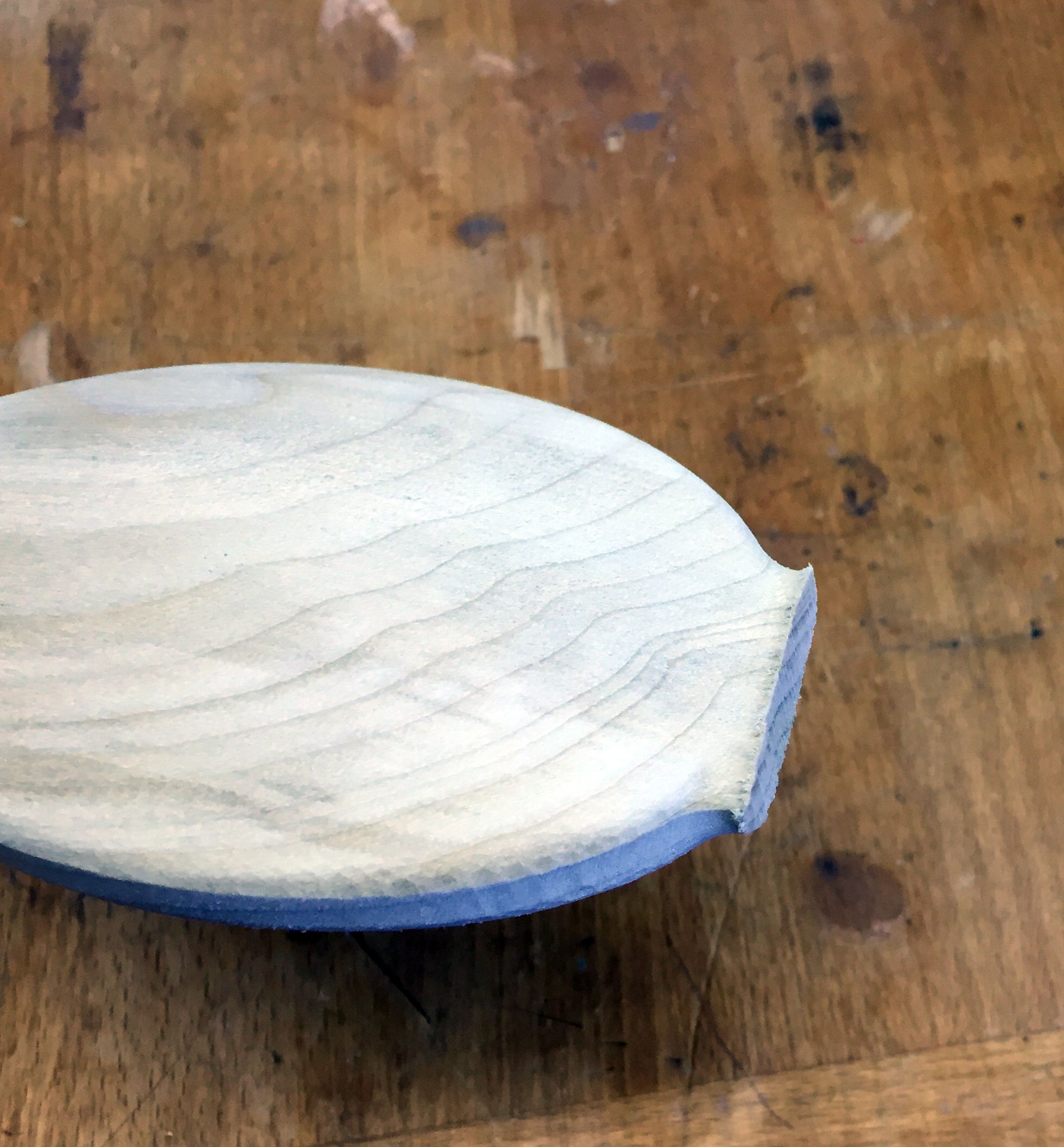

4) With one hand on the scrap and miter and the other on the spoon, cut through the tab, leaving enough material behind to shape and sand by hand (see below). Repeat on the other side.

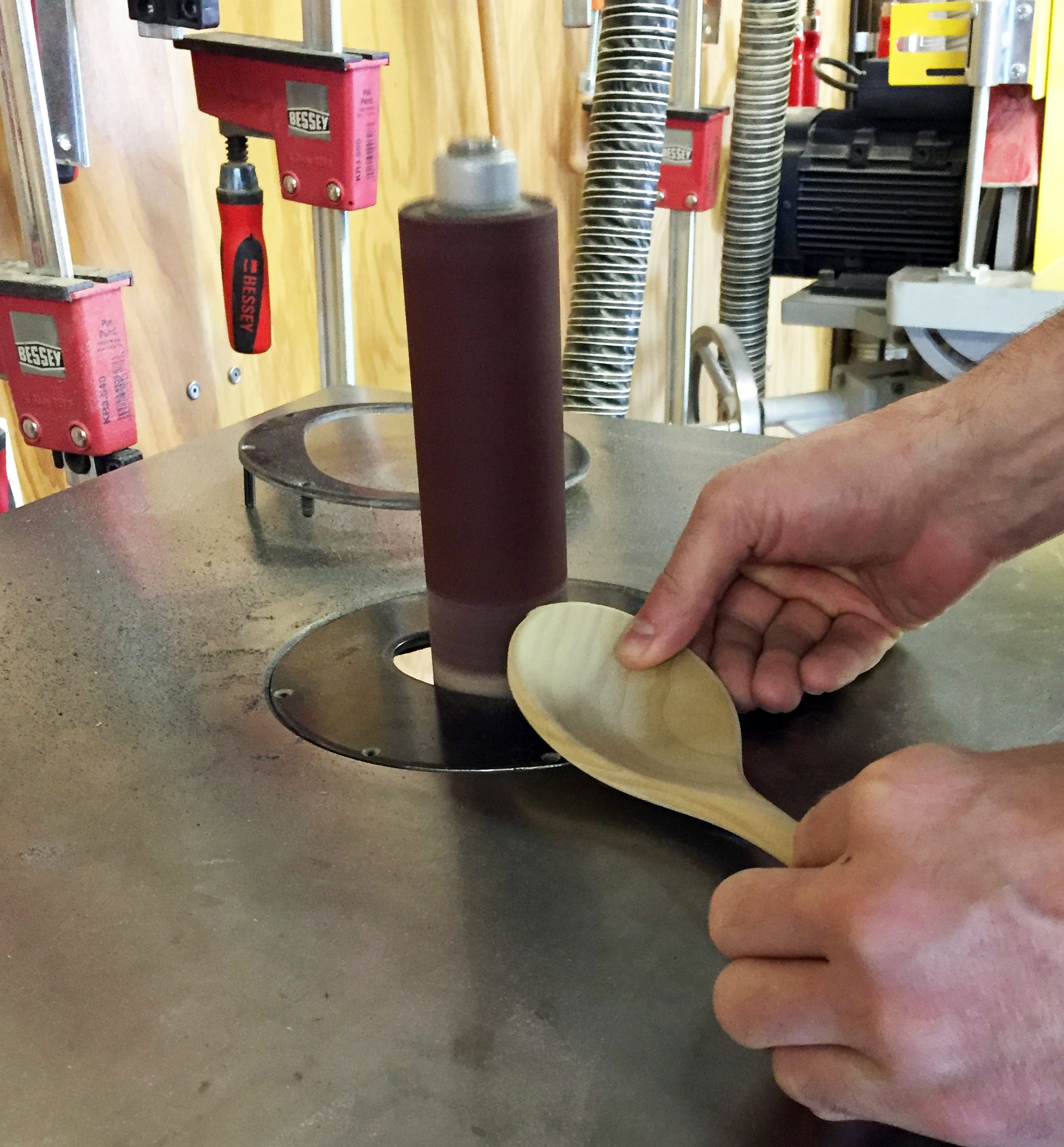

5) Clean up the tabs roughly with the spindle sander.

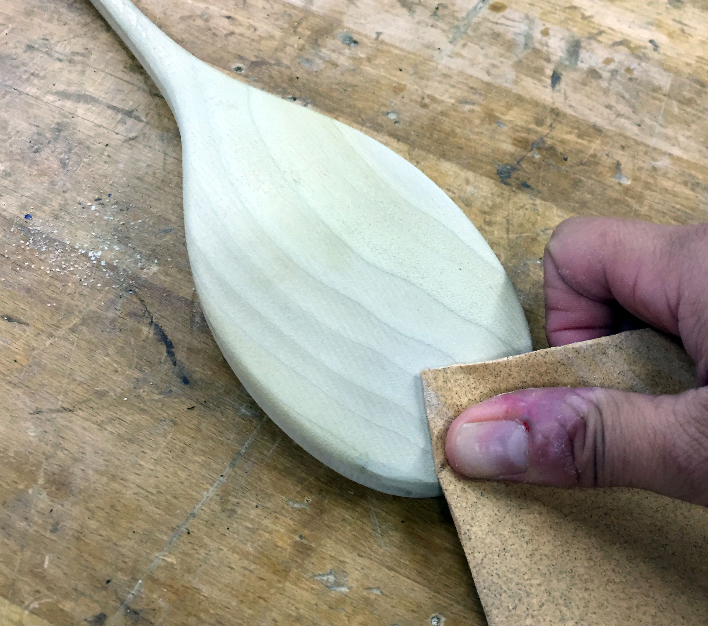

6) Use sandpaper and finish up by hand.
