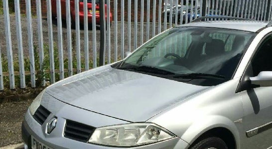

Quick and easy guide to changing the spark plugs and ignition coils on a Renault Megane 05 plate 1.6 petrol engine.
I am by no means a mechanic and am purely self taught through research and just giving it a go.
I thought I'd share my experience, yours may vary, but this fixed my problem.
The car suffered from lack of power and chugging when low revs and the 'Toxic Fume Warning Light' appeared on the dash.
The Internet provided me with enough knowledge to help me decide to give it a go myself, saving £££ on garage labour.
Hope this helps others in turn!
I did not need to replace all the plugs and coils at once, I could have done them 1 at a time to find out which ones where causing the problem, however, I knew if I changed all of them I would have peace of mind that they were all new and shouldn't cause an issue for a long time(touch wood!!)
This cost me just under £100 and took me about 20mins to complete.
