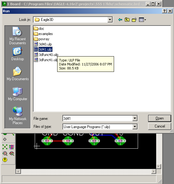

After installing the required software, you need to generate a POV file that is read by POV-Ray. To do this, open up your board in EAGLE. Then, click File>Run. You want to find the install directory of Eagle3D, and find where the ULP files are stored (mine were stored at C:\Program Files\Eagle\ULP\Eagle3D). If you are running a version of EAGLE later than 4.1x, you'll want to select 3d41.ulp. If not, select 3d40.ulp. Click Open and a file generation interface should pop up. This is where you will make your selections on how the rendered board will look. I usually leave the settings to their default positions, unless I am using custom created parts. Then click Create POV file and exit. A message should appear telling you that your POV file has been created successfully.

Eagle3D uses special #include files when it is scripting, and you need to give these files to POV-Ray for your image to render. First, go into your Eagle3D program directory. Find the folder named POV-Ray, and copy the files to the "include" folder in the POV-Ray root directory. (Picture 1)
