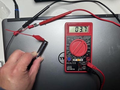

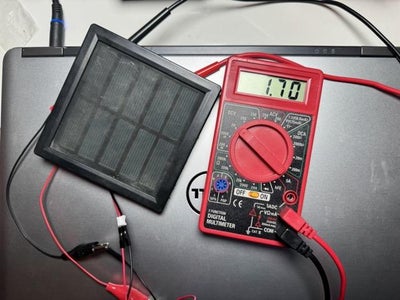

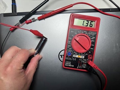

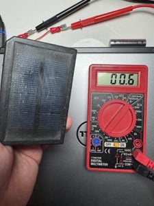

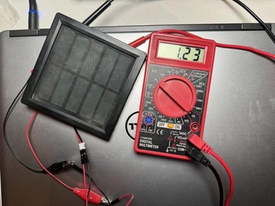

For this lab, the students have an opportunity to test different solar panels by measuring them with a multimeter and their electrical effectiveness in different conditions. First, we have different size solar cells (mini and small or others). Then, these are tested under conditions to simulate cloudiness (color filters), and different lamp types, incandescent vs led vs halogen, and finally, if possible, testing in the outside full sun and in the shade outside.

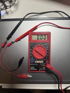

I. INTRODUCTION TO MULTIMETER FUNCTIONS
II. INTRODUCTION TO TESTING - TESTING THE RECHARGEABLE AA BATTERY

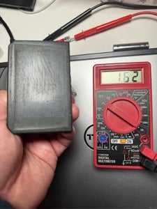

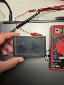

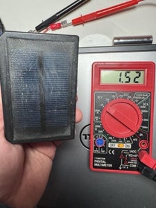

III. TESTING A SMALL SOLAR PANEL (voltage and current)

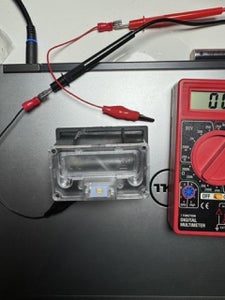

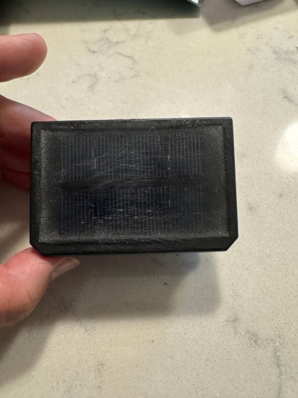

IV. INSIDE OF SOLAR LAMP AND CONNECTION POINTS
V. TESTING A MINI SOLAR PANEL - VARYING DISTANCE/BRIGHTNESS OF LIGHT SOURCES

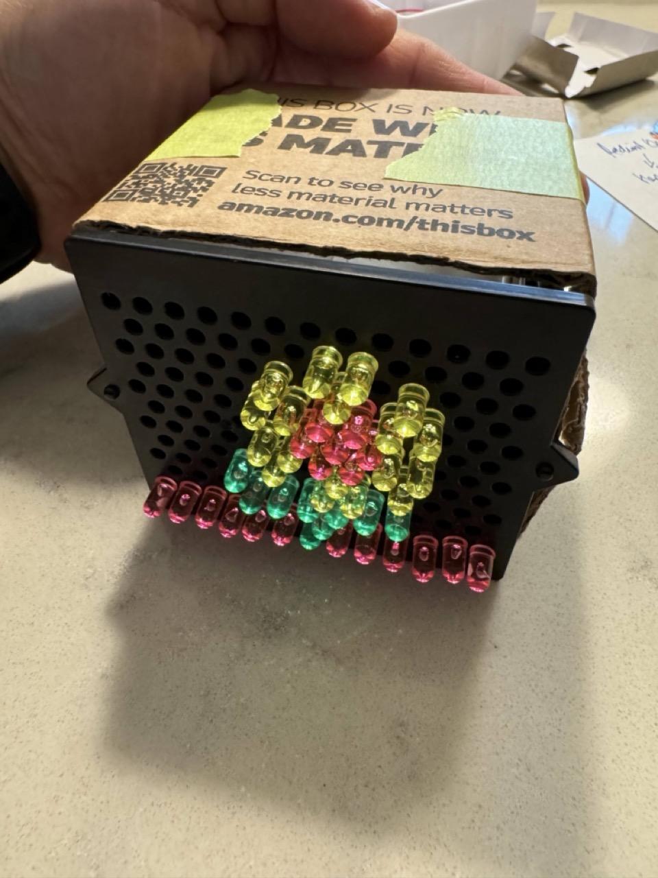

Step 3: Solar Energy Lightbox Project
Teacher presents the attached pdf presentation.
A link to the tinkercad project: Solar Powered Lightbox Project
a link to tinkercad project for led plate: LED Plate Solar Lightbox

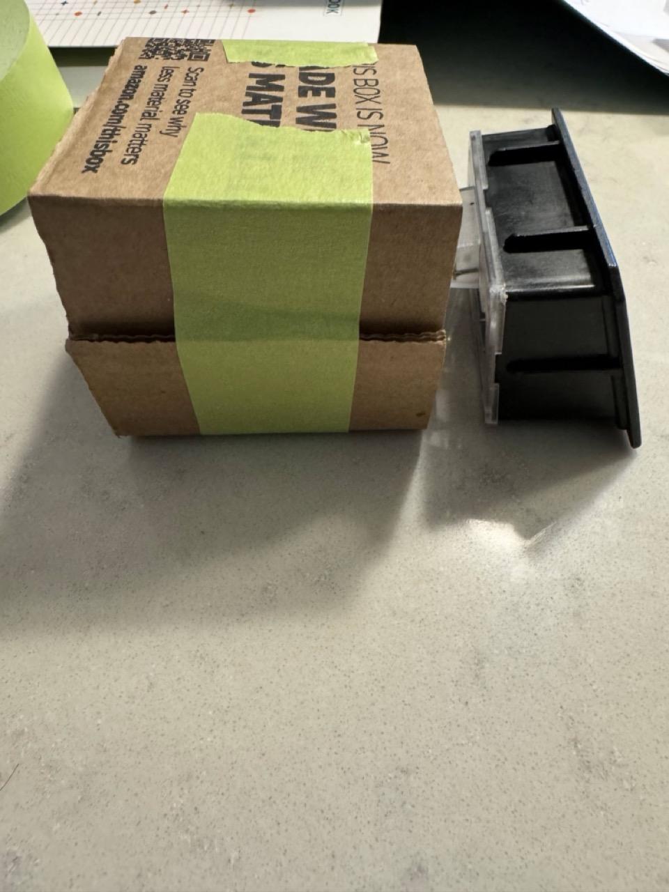

Step 2 - Gather Materials

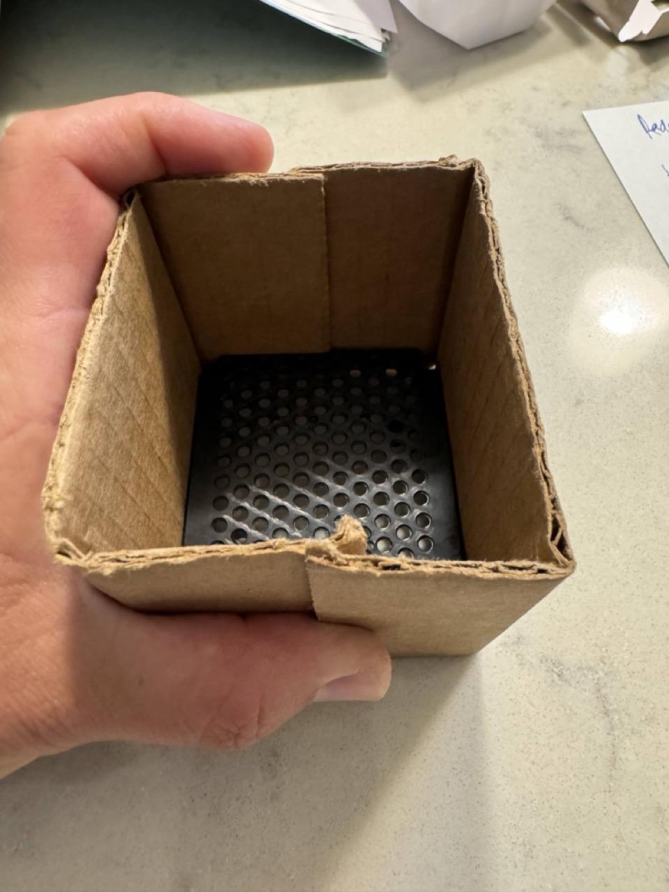

- cardboard scraps, create 2 pieces to form simple box top and bottom. each piece will be 15.5cm wide and 7.5cm tall.
- crease the cardboard pieces at 38mm from each edge
- tape the two halves together

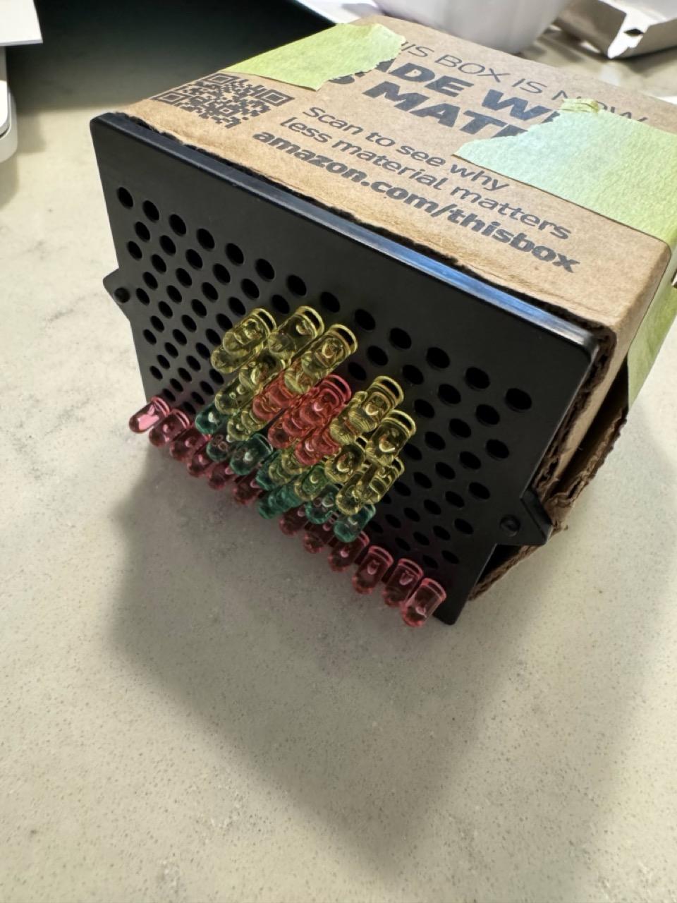

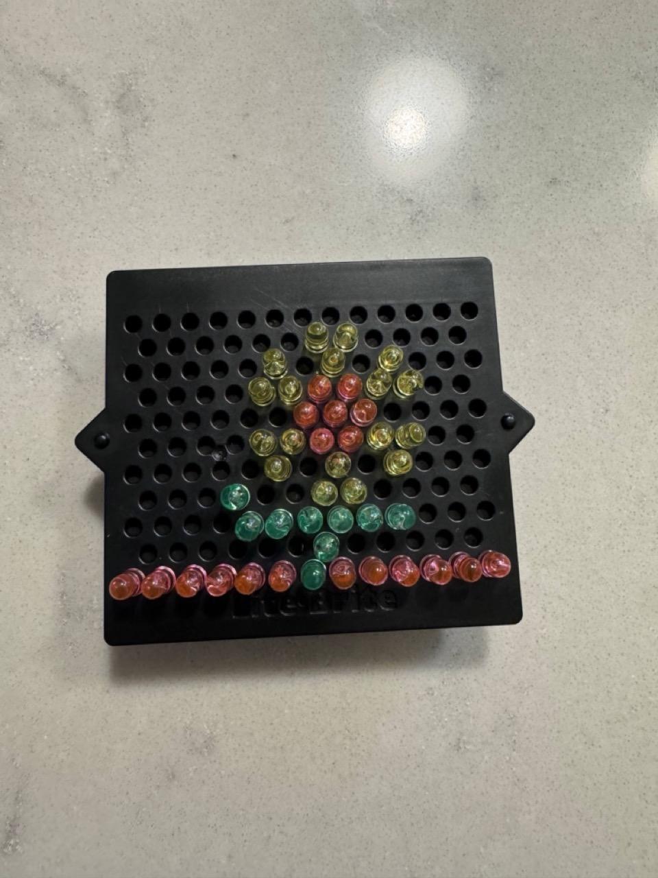

- if using a litebrite mini, you will need to remove the peg board from the led backing, we won't use the backing for this project.
- if 3d printing the peg board, you will need to create 2 plate pieces, 77mm wide and 71mm tall with 11 rows of holes, alternating 13 holes, 12 holes, 13, etc. Between the 2 plates, you will place some membrane, maybe foil or landscape fabric.
- I'm using a pretty standard garden light sold at Costco, but if using another type, you may need to create another piece for the back to fit better into the cardboard holder.

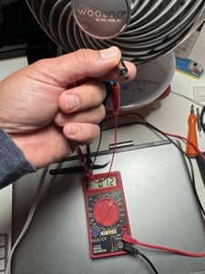

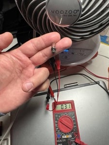

Wind Power Generator - Measurement of different blades and power generation.
