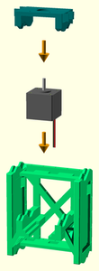

Step 13: X Motor Segment Assembly
Seat the stepper motor with drive gear in the X/Y motor rail segment (lighter green). Clamp it into place with a motor mount plate (dark green) with micro-switch. Route the wiring out one end.

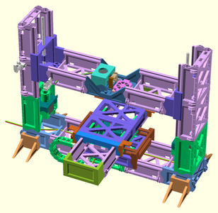

Step 16: X Axis Assembly: Step Three
Join the X sled cable-chain mount (White) to the front/left side of the X sled endstop (Burnt orange).
Step 17: X Axis Assembly: Step Four
Join an X sled endcap assembly (white/burnt orange) to one end of the X sled central assembly (Purple).
Step 18: X Axis Assembly: Step Five
Slide the X sled partial assembly (purple) onto the X axis rails assembly (pink/green), so that it is centered.
Step 19: X Axis Assembly: Step Six
Connect the Y axis assembly to the XY joiner on the X axis partial assembly. Route the Y axis wiring through the front hole in the XY joiner.
Step 20: X Axis Assembly: Step Seven
Join the other X sled endcap assembly (burnt orange) to the end of the X sled assembly (rainbow), fixing the Y sled assembly in place.
Step 21: X Axis Assembly: Step Eight
Attach the cable chain joiner mount (white) to the X motor segment, on the same side as the X sled cable chain joiner and Y axis wiring.
Step 22: X Axis Assembly: Step Nine
Attach the cable-chain assembly (green with 13 or 14 links) to the cable chain mounts on the X axis assembly, making sure to feed the Y-axis wiring through the cable chain. Route the wiring in through the wiring access hole beside the cable chain mount, then out through the end of the X axis assembly.

Step 47: Final Chassis Assembly: Step One
Attach the right Z tower assembly to the right end of the XY axes assembly. Route the right tower wiring through the rear X axis wiring access holes.
Step 48: Final Chassis Assembly: Step Two
Attach the left Z tower assembly to the left end of the XY axes assembly. Route all wiring out the back of the left Z tower base.
Step 49: Final Chassis Assembly: Step Three
Lower the extruder bridge down into the Z tower grooves. Once the threaded rods meet the threading in the z-sleds, you will need to begin turning the stepper motor coupling evenly on both sides to move the extruder assembly low enough to attach the z end cap and spool holder.
Step 50: Final Chassis Assembly: Step Four
Attach a limit microswitch, with wiring, to the Z rail endcap.
Step 51: Final Chassis Assembly: Step Five
Attach the Z tower endcap to the left Z tower. Route the limit switch wiring down through the wiring access holes in the left Z tower, and out the back of the base with the other wiring.
Step 52: Final Chassis Assembly: Step Six
Attach a cable chain (17 links) from the extruder bridge cable chain mount to the left Z tower cable chain mount. Route the extruder bridge wiring up through the cable chain, back into the left Z tower through the wiring access hole below the cable chain mount, down the left Z tower, and back out the motor rail segment to where the controller board will be mounted. Be patient. Once the chain is assembled the links make for great cable management, but frustration and rushing can lead to broken links. Take your time.
