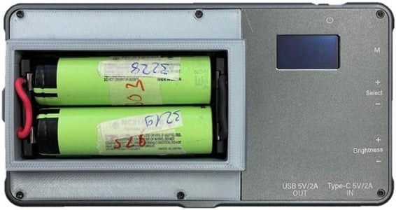

My LiFePo battery in the DP-VLRGB went faulty. Instead of disposing of the whole device, I removed the battery and replaced it with 18650 cells. I had to design and print a new cover because the 18650 cells are thicker than the pouch cell.

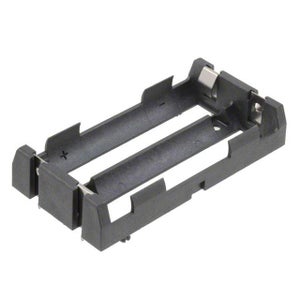

1 pce, 18650 battery holder (single or double)

Step 1: Prepare Battery Holder
For reference, refer to the cover image or figure 1 in step 5. Connect the two positive poles on the battery holder as short as possible. Solder on a 150 mm red cable for the later connection to the circuit board.
Repeat the step with the negative pole.

Step 5: Insert New Battery Circuit
No batteries are inserted now!
Take the battery holder from step 1 and solder the red cable to pad B+ on the circuit board.
Repeat the step with the black cable and pad B-.
Pad B+ is covered with insulating tape to prevent an electrical connection with the metal cover.
Reposition the white insulation under the display so that pad B- is covered.
Position the battery holder with the new cover.
Screw on the new battery cover. You can then fit the shortened metal cover.
Test the device with an 18650 battery. The battery is inserted with plus + on the side with the red cable. The markings on the holder have no significance.
