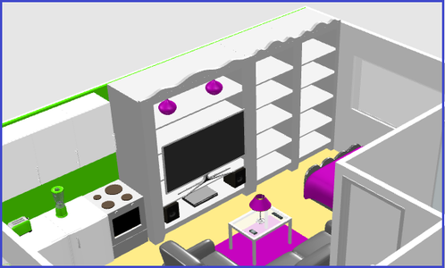

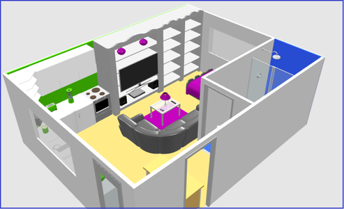

1.) I started by completely clearing out the wall unit, then with my trusty tape measure and notepad app on my phone, I measured and took notes of all of the aspects of the unit... width, length, height, frame sizes, shelves etc. I also took some photos because there's nothing quite like before and after shoots, and useful to visualize the unit while designing it in my old apartment. I also took notes of all of the repairs I noticed.
2.) I drew up some ideas on a paper note pad, and when I was happy with a design I made a proper design diagram using the Sweet Home 3D design software. It has a handy drawing canvas grid with full scale measurements so I used this with the measurements I had taken from the unit taking into account the size of extra timber I might need to purchase and the items to go on the unit such as the TV, electric fire etc. (As you can see in the pictures, I actually designed the whole apartment with the software and using the 3D view which you can move around to see all angles, was very helpful to visualize the apartment and the wall unit specifically).
3.) With the digital design of my new centerpiece, I took my laptop to my new apartment and remeasured the wall unit again to double check that all of the numbers matched to what I previously took down, and matched the design measurements on the digital plans, making any necessary adjustments to the final design plans. Job done.

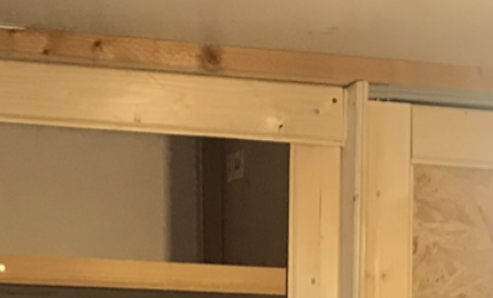

Building the doors. I started With the wardrobe doors, the the office space ones... same thing, just smaller.
1.) Using some OSB sheets, I cut them to size with a hand held circular saw two full length panels, making them about 3cm shorter than the units outer frame to take into account the size of the slide rails and pinions from the bi-fold door fixing kit.
2.) Once cut, I laid the two OSB panels on the floor, then measures and cut four lengths of T&G (two for each door).
3.) Then, with the tongue facing inwards, I laid the T&G on the floor and put the OSB on top making sure the outer edges were flush along the length of the door panels, then wood glued and screwed together.
4.) The same was done going across the width of the doors across the bottoms, tops and three short lengths in between, making four square sections per door.
The folding door kit I used has an aluminum runner, hinges, an upper pivot pin with a long shaft (for the top of the door), a lower pivot pin with a short shaft (for the bottom of the door), another door runner pin for the top of the door that keeps the doors within the runner, two fixing plates and a door knob (I used my own in the end), and a pack of screws and instructions. I will refer to the two parts of the wardrobe bi-fold doors as door A and B.
5.) Drill a hole through the top edge corner of door A, and another hole equally located in the bottom edge corner. Drill a further hole through the top edge corner of door B, opposite corner from door A, which is for the door runner pin. The holes should be about 3cm or so from the side edge and dead center of the door widths. The holes should be just slightly smaller than the pivot pins for a firm push fit or light tap with a hammer.
6.) Turn the doors over on the floor or your work surface, making sure the pivot pins are still in the same locations, then push the two doors together. Now drill and screw in the door hinges... top, middle, bottom, making sure the hinge shafts are equally centered between the two doors.
7.) Now the fixing plates need to be fitted. These were fitted to the bottom of the top door frame and equally located on the bottom top door frame, or in my case the top and bottom outer wall unit frame. These are where the pivot pins sit and located to the side of where the door opens (think of it similar to standard door hinges). Then holes were drilled into the unit frame, the same size as the pivot pin shafts.
8.) Next, measure and cut to size the aluminum runner, then drill and screw the runner to the bottom side of the top outer unit frame next to the top fixing plate.
9.) The doors could now be fitted by lifting the door half way open and slotting the top pivot pin into the fixing plate, and door runner pin into the runner. Then move the bottom of the door and slot in the bottom pivot pin by dropping it into place. The longer shaft on the top pivot pin enables you to push the doors up as far as they can go, and then drop down slightly when fitting the lower pin into its fixing plate. At that point, the door knob could be screwed in and doors ready to use. Then I followed the whole process again for making the smaller office area doors.

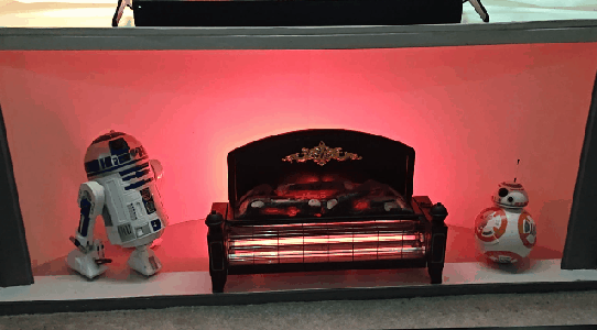

A short and sweet step where I sorted out the electric fire place. The fire had a orangey red bayonet fitting light bulb, a metal rod with shiny metal fins that would rotate from the heat of the light bulb giving a licking flame effect, and a plastic cover with faux log/coal look. There was also a metal tray running the length of the fire with a hole in the middle where the bulb would fit through. This was to reflect the heat from the bulb to help make the flame effect rod rotate and to reflect the light.
The Repair:
A simple one. Simply replace the light bulb that had blown. But I didn't swap the bulb like for like as I felt I could improve on the flame effect.
The Improvements:
The issue I had with the original flame effect was that when the flame effect rod rotated, it made it look like the flames were going sideways, I know, right. I've not seen real flames go sideways except for an outside firepit on a really windy day, or from a blowtorch. I wanted my faux flames to go, up. I had seen LED flame effect bulbs around, so managed to find and purchase one with the same operating voltage and bayonet fitting.
1.) I removed the plastic faux log/coal cover, then the metal flame effect rod and the old bulb. This was when I noticed that the hole in the metal tray was too small for the new bulb. I rested the new bulb onto the top of the hole, marked around it, removed the bulb and unscrewed the tray.
2.) With a metal cutting blade in my jigsaw, I cut out the excess metal to make the hole bigger, the refitted the tray, then successfully fitted the new LED flame effect bulb. A quick test and the effect looked much better.
3.) When I put the faux log cover back on, the flame effect looked a little dark. I removed the cover again and used the tip of a hobby knife to scrape away some of the black paint, wiped the cover clean and replaced it. It looked better, but I repeated the process a few times until I was happy. I finally replace the cover, screwed it down, and I ended up with a much brighter flame effect... with flames that finally looked and flickered like a real fire.
4.) The next job was to use some 3mm HIPS sheets I purchased to make a curved back panel in the actual fire place. This was simply done by cutting the sheets to full height of the bottom shelf/base, sliding in the sheets matt side facing out, pushing the middle back towards the upper shelf's CLS batten, then drilled and screwed in a single screw to hold the sheets in place. The matt finish side of the HIPS sheets will help with the following addition.
5.) The final improvement was to cut out a section of leftover sheet of PVC I had to match the back of the electric fire, added a couple of lengths of double sided 3M VHB tape to the panel and attach it to the back of the fire.
6.) Next was to stick a one meter length of smart RGB LED strip to the PVC panel. One the LED strip was connected to the app, I chose a flame/fire effect scene that was available on the LED strips app. Then I plugged the strip into another smart plug.
7.) Finally, the fire was put into place, the fire and LED cable fed through the join of the HIPS backing sheet, plugged in to the mains, then using the smart plug app, I created a scene so both the fire and LED backing lights would turn On and Off at the same time. A final test at night produced a nice flame effect from the front of the electric fire, and a nice gentle flickering glow reflecting off the matt side of the HIPS backing panel.
As an extra touch, I had some faux glass stones left over from an old ornament now long gone. I spread the stones on top of the metal tray near the light bulb to help spread out the flame reflection.
NOTE: For convenience, the LED RGB strip lights I used have a memory function. This function remembers the last colour or lighting effect scene that was used when the power is turned off then switched back on again. Other LED strips without this memory function will reset to a default start colour or scene, meaning you would have to open the app and set the colour or scene again every time you switch the strip lights on.
