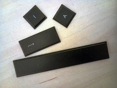

First disassemble the remote control.
Now is the time to clean* it if you like.
(* See notes at the end)
We will focus on the rubber part with the buttons.

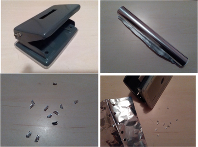

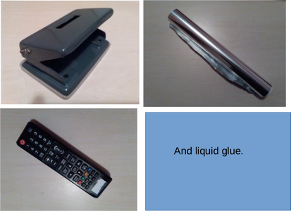

Step 2: Tinfoil Small Circles
Use the perforator (or scissors) to cut small round pieces of tinfoil.
Step 3: Glue One Piece to the Button That Is Not Responding.
Use one small piece of tinfoil and glue it in place as shown in the picture.
