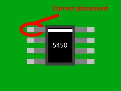

It's a good idea to mark the polarity of the chip, or the way it goes, because if you get it wrong it'll just blow again. Taking a picture before you desolder the original chip is a good idea.
The end on your new chip with a line is the polarity. Match that to the notch in the white outline under the chip, IE, with the line facing away from the fuse socket. Make sure it's lined up well with the solder pads. Try to get it as close as is reasonably possible, but don't worry too much if it's not perfect.
Take your soldering iron, put a little solder on the end, and while holding the chip in place (You could use a pencil or some pointy implement), apply the tip to each of the pads/pins that we soldered beforehand, as seen in the picture. Make sure the solder flows around the pin and the pad to make a nice clean solder joint.
