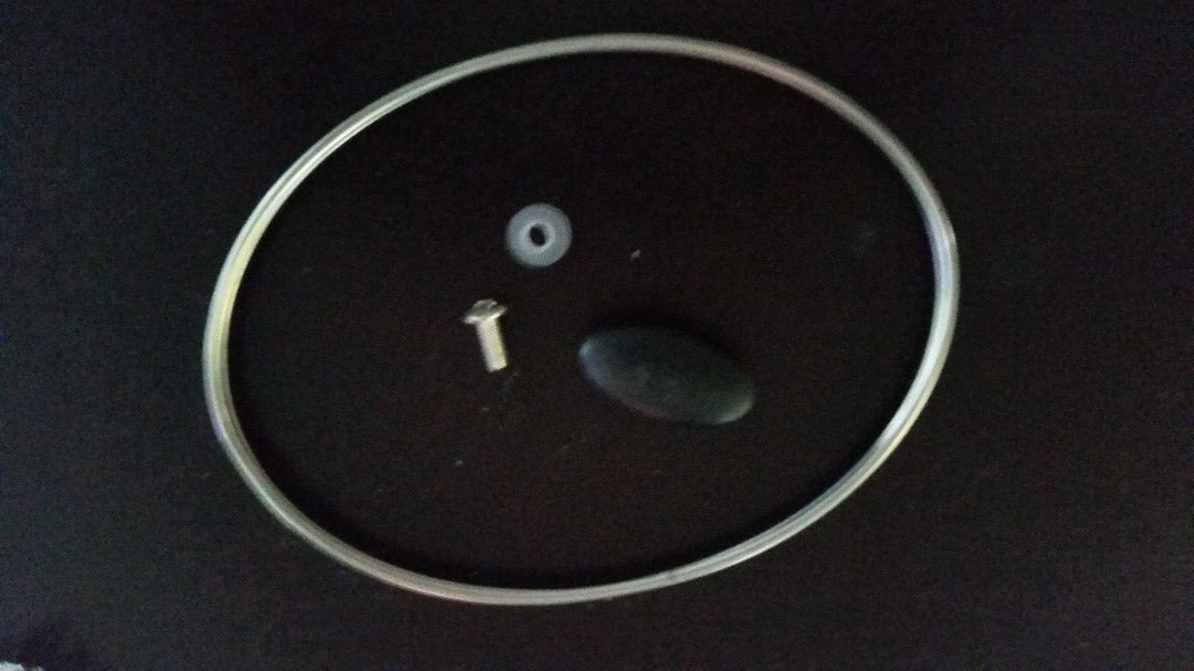

- Metal Oval Frame from original lid
- Plastic Handle from original lid

Step 2: Prep the Old Lid
The first good thing about this replacement is that we kept the original metal frame and handle from the broken lid. There is a channel all the way around on the inside of this frame, where the glass was held in the metal frame. This lip needs to be cleaned and any glass fragments removed. The glass used on my lid was safety glass, meaning that it is supposed to be less likely to break, or less likely to pose a threat when broken. This means I am less likely to cut myself removing the small chucks that are still in the metal frame. FYI, I did say less likely, this is still sharp and overconfidence leads to small paper cut like slices on your knuckles. Regardless of what the glass is, these cuts HURT. So take your time on this step and think about wearing gloves.
To remove the glass, I used a small screwdriver in the channel and chiseled away at the glass chucks. Probably not the best option but it worked for me with no special tools. Make sure to throw all those chunks away, as no one wants to step on them later.

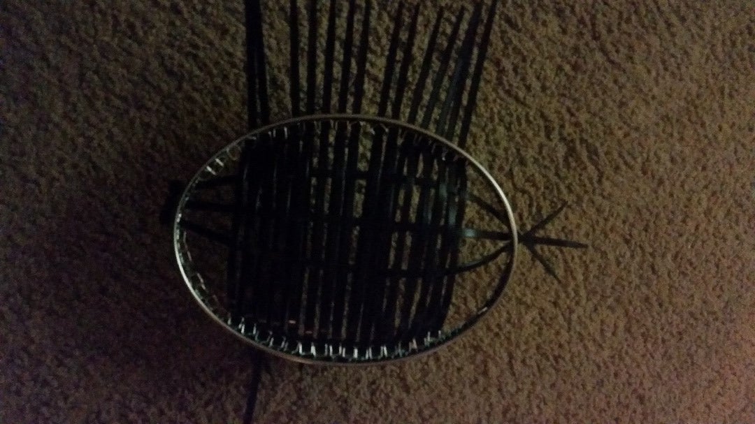

Step 6: Vertical Zip Tie Lines
Now that the super glue is dry and the hook and loop is securely in place, you can begin the zip tie weave.
I chose to start in the middle of the longest edge. Depending on what design you are going for, you may want to start somewhere else. Take a little string and play with ideas on how you want yours to look, then when you have a plan, start using zip ties.
Here is how my plan played out:
- Starting on what looked to be the middle of one side of the longest edge I inserted an 8" zip tie down through the square jump ring and pulled it through, all the way to the ratchet head.
- Then I needed to count around the jump rings, to the half way point on the other side. In this case I used 60 jump rings, so half way was 30. I inserted the other end of the same zip tie up into the 30th jump ring. Now the zip tie spans the whole distance. And the ratchet head and open end both face up through the square jump rings.
- Taking a second 8" zip tie, connect it to the mounted zip tie, on top of the frame. Don't pull very tight yet, you can work on the shape of the lid in a few, start by just getting a few zip ties mounted.
A simple note, remember this is a lid, and that the lid must sit on the crock pot, thus these zip tie ratchet heads, must all be on 1 side of the lid (the top side). A the metal ring should rest on the crock pot when you put on the lid. I didn't think about this until after that fact on my lid.
- Next inserted a zip tie down through the jump ring to left of the one you just attached to the frame, staying vertical on the first zip tie. Insert the end of the zip tie up into the jump ring to the left of the one already mounted. Creating a second vertical line.
- Attach the second zip tie to the mounted zip tie, on top of the frame that you just pulled through.
- Now go one zip tie to the right of the first one you attached and install the next vertical line.
- Continue going one zip tie to the left and then right, until you have completed vertical zip tie lines all the way across the longest side of the lid. There will be a point when the curve is too tight to get the zip ties to lay flat. In my case I found that the smaller 5" zip ties were long enough to span the distance, and since they are not as wide, I could fit them on the edges. Thus I have 2 lines of the thinner 5" zip ties on each sides.
- After the vertical lines have been installed you can tighten the zip ties. Keeping in mind that this is a lid, I let the center of the lid be slightly taller and it curved down as it went out. The bottom lays flat.
You should now have something that resembles Shredders mask from Teenage Mutation Ninja Turtles, Well maybe not, but it does look weird.
Step 7: Zip Tie Weave
Now for the horizontal lines. Since my lid is not large I don't have many horizontal lines, In fact I could only fit 5.
- Using a long 11" zip tie, find the center of the unused square jump rings. I had 13 squares on each side, so center was 7.
- Insert a long zip tie down through the center square jump ring (my #7) and pulled it partially through.
- Now weave the end of the zip tie over the first vertical zip tie, and under the next. Continue the up and down weaving through all the zip ties all the way across the lid.
- When you reach the end, make sure to pull the zip tie up through the square jump ring. Remember that the zip tie ratchet heads, must all be on 1 side of the lid (the top side). Otherwise you lid won't work very well.
- I chose to weave all the top zip ties before connecting the base zip ties this time. Just so it would be easier to move things as I weaved each zip tie. So, insert the next a long zip tie down through the jump ring to the left of the newly weaved horizontal zip tie. Weave the opposite directions that you did for the last one. Under the first vertical zip tie, and over the next. Continue the up and down weaving through all the vertical zip ties all the way across the lid.
- When you reach the end, make sure to pull the new horizontal zip tie up through the square jump ring.
- Continue this process of weaving all the horizontal zip ties until you can no longer weave. There may be a few unused square jump rings, depending on space. I ran out of flexable movement after a few horizontal lines.
- For the bottom of my lid, I didn't weave the long zip tie, I just pulled it straight through the middle and attached the bottom zip tie to the top.
- Pull the long zip ties tight enough to keep your shape and secure your design.
You should now have something that resembles a weaved Shredder Mask with zip tie tails pointing our in all directions.

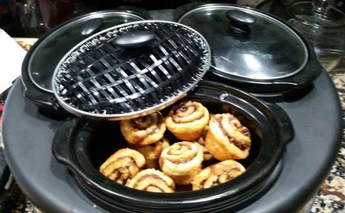

Step 9: Put the Handle Back on the Lid
Since we were able to save the original Plastic Handle with the screw and spacer from the old lid, This was easy to install. Just insert the screw through the bottom of the lid and screw the handle into place.
Voilà - your new lid is complete and ready for use!
