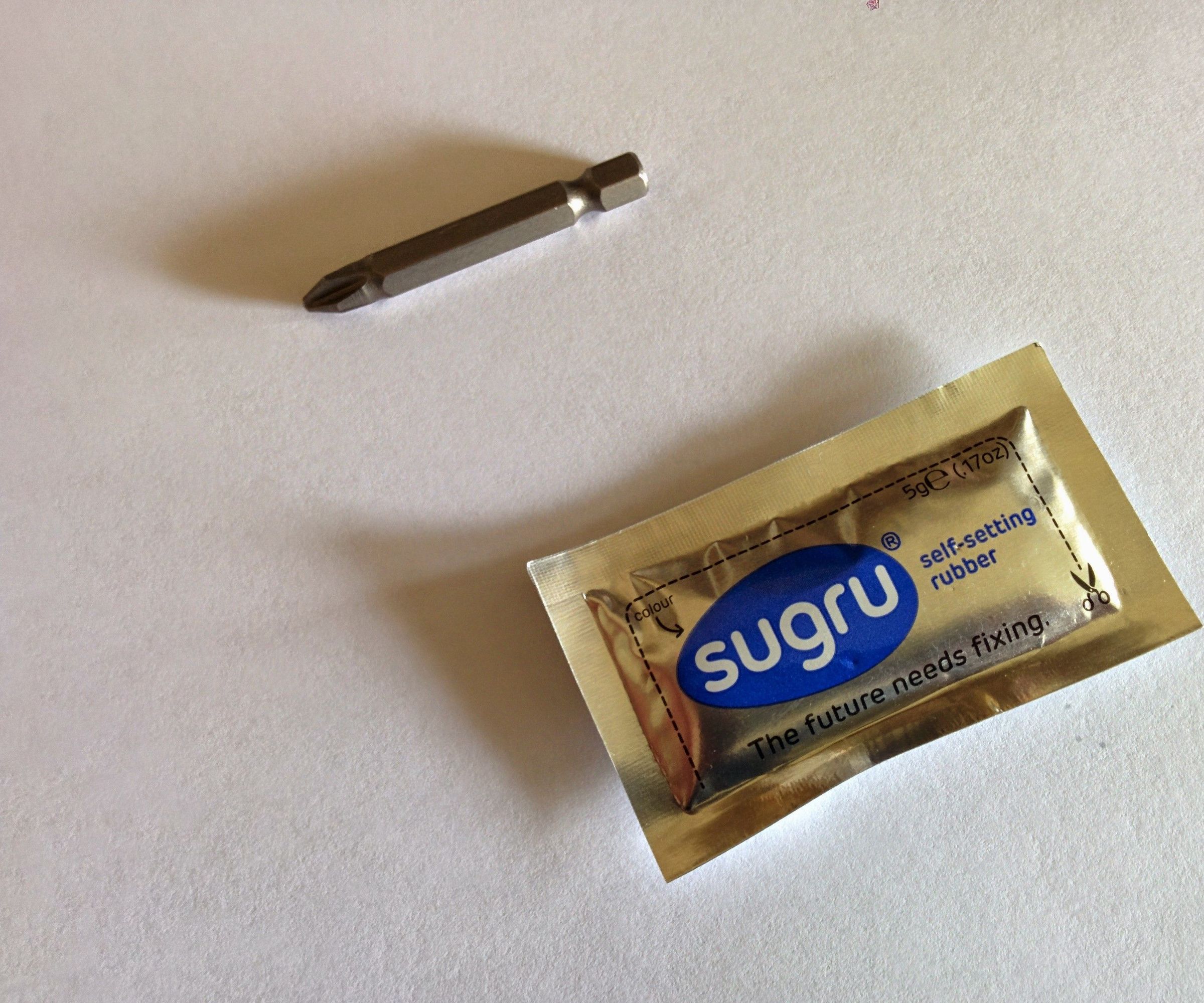

- One mini packet of Sugru

Step 1: Apply Sugru Into the Lens Holder
Open the pack of Sugru. You will need only a tiny amount, about the size of a lentil. You may want to only open up one end of the pack, so you can reseal it immediately and save your Sugru for later, since it's kind of precious stuff.
PUT ON YOUR GLOVES
Never, ever get body oils onto the lens or lens assembly, and never pick up the lens with your bare finger. It also will prevent the Sugru from sticking to the lens and performing it's job. As the lens heats and contracts, the Sugru has to be able to keep up or the lens could fall out.
With the gloves on, roll the Sugru into a very thin line, like making a snake. Take your time, make it even, and make sure it can go the full circumference of the holder.
