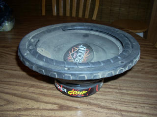

Push your needle through the cone, approximately 1/8" to 1/4" from the outer edge. You may start from the top of the cone or the underside, I found it easier to start from the underside going up. Pull your thread tight, and then push down through the ribbing, near the inside edge. Keep the stitch tight. Repeat this until you have gone all the way around your cone or have run out of thread (in which case, thread your needle again and start where you left off by just overlapping the last stitches). Tie off and cut the thread.

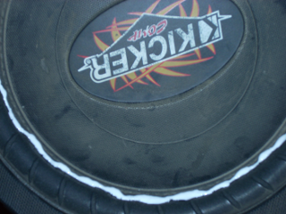

Now that you have stitched the cone, it's time to add a second layer of structural integrity to your speakers. Run a semi-consistent bead over your stitched area. It doesn't have to be thick. Use your glue spreading apparatus to cover your thread evenly with the glue, taking care not to wipe too much glue off.

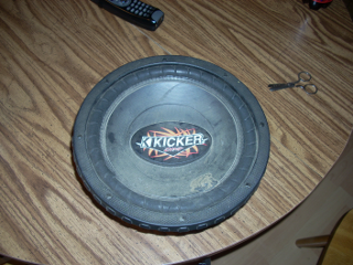

I did this when I bought a sub box set (shown in this step) with amp and speakers for $30. The cone on the left had been mostly blown, and I'm just too cheap to go out and buy a new one. It's been two years since I've repaired that cone, and I can safely say that it still hasn't ripped out after much bass punishment. The same cannot be said for the right side speaker, which did not get stitched and glued when I got the set. I will be repairing that when I get a roundtuit.

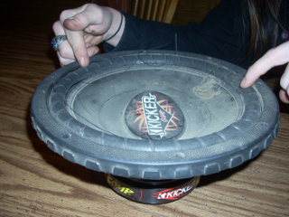

- You've used thread to pull the cone back to the ribbing. The thread should take the brunt of any punishing bass beats you throw at your speakers. Keeping the stitching tight means that your cones won't rattle against the ribbing on those low notes.
- You've glued the threading and cone edge to the ribbing. This has sealed the cone completely around the ripped area, preventing any serious loss in sound quality. It also helps alleviate the strain that would normally be applied to the points where the thread is stitched through the cone and ribbing by increasing the fastened surface area.
