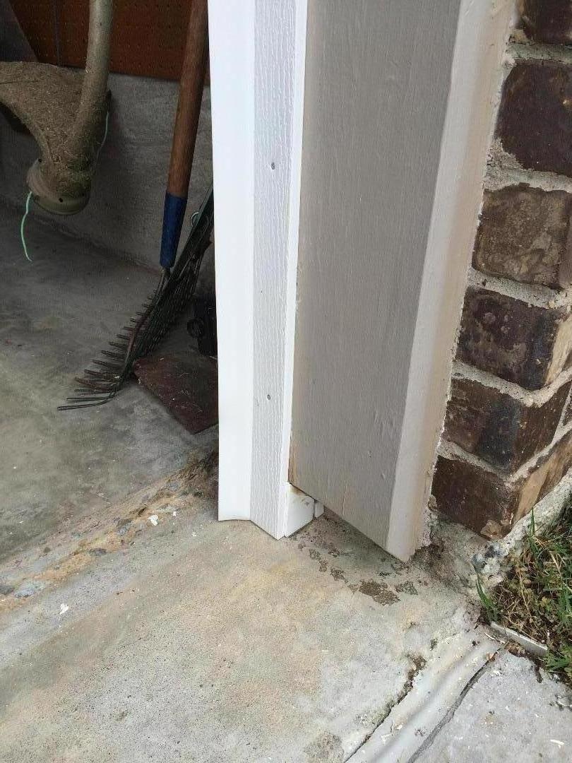

The builder-installed PVC weatherstripping, shown in the pictures, is low quality and warps. it is unsightly and wasps and mud-dabbers are always flying in my garage. Additionally, rodents are sneaking in the crack in the corner, since the door casing and weatherstripping stop short of the concrete.

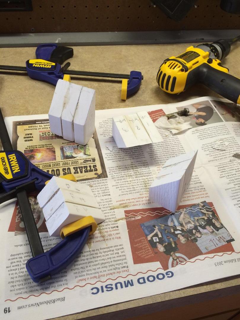

I will use some 3/4" thick PVC scraps to build up custom fit blocks to fill the gap and provide backing so that the weatherstripping can go all the way down. Install with construction adhesive, then caulk and paint.
Step 3: Build PVC Blocks
This part is tedious: Cut pieces of PVC to build up a block that custom fits each corner you need to fill. I had to make four, since I have a two garage doors.
After you have a test fit that will work within construction adhesive and caulking tolerances, label the pieces and glue them up with construction adhesive.

  1. Remove the old weatherstriping.
  2. Line the PVC filler block up with the back of the door trim, and flush with the surface the weatherstripping will be attached to.
  3. Glue it in with construction adhesive. In the photo, you can see on this particular repair I also had to add a very small bock of PVC behind the trapezoidal block. Do what you need to leave no larger than 1/4" cracks.
