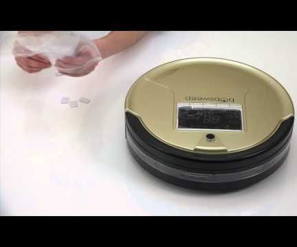

Introduction: Repair BObsweep's Floor Sensors
These video and instructable guides cover opening and closing of bObsweep Standard or Pethair, as well as replacing the floor detection sensors.
Step 1: Open Up Bob

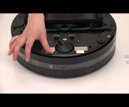

Flip Bob over and remove the 7 screws which hold the cover together.
There are five screws around bObsweep's edges. Two are installed at the top and bottom, and one on the right end of the main brush.
Remove the main brush. Unscrew the holder, and lift the brush out. Keep this screw separate from the others.
There are two screw holes inside the brush compartment: one in the centre, one on the left end. Remove both and keep aside for reassembly.
Note: Depending on your model, there may be only 6 screws installed on bObsweep.

Step 3: Remove the Floor Detection Sensors
There are four ground detecting sensors inside bObsweep, found in front of the main board.
Use your screwdriver to remove all 8 screws holding the sensors in place. There are 2 on each sensor.
Note: Remember to keep any parts removed from bObsweep safe for installation after your repair.
Step 4: Detach the Sensors From the Main Board
Lift the sensors out of bObsweep. All four are wired to the same circuit plug.
You will need to feed some of the wires underneath the main board to remove all the sensors.
Detach the multicolored circuit plug which connects the sensors to the main board to remove fully.
Note: There are two plastic parts inside bObsweep that stay inside when replacing the floor sensors. If they are accidentally removed with the floor sensor piece, place them back inside.
