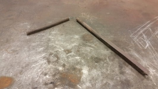

Some time ago, at least two years, one of the pry-bars I favor broke, probably from abuse. So recently I finally took time to tackle the project of repairing it. Because why would I throw anything away that I can fix? The only problem was finding the time to do it.

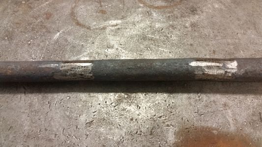

This was the easiest step because it was the most familiar process to me. First I took the broken pry-bar and beveled the edges of the break using the lathe. Lathes work super slick for bevel treatments of round stuff in preparation of welding. The bevel is exactly what you want and is uniform around the whole circumference.
Next I pre-heated both ends of the bar. Pre-heated material leads to stronger welds. I am uncertain of the pre-heat temperature. The infrared thermometer I used did not have enough range. And the temp stick I have is only 200 degrees Fahrenheit.
After that I aligned the pieces of the pry-bar for welding. I was especially careful to prevent making a crook in the bar. Once satisfied with the alignment I proceeded to weld the bar back together, making it one piece instead of two.

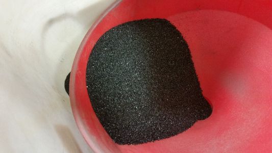

So I needed to return the molecular structure to something more like its native state. Which means heat treating. I know a little bit about the processes involved, but I am by no measure an expert of the topic. While the weld was still hot I applied heat until the weld and a few inches to either side of it were glowing red. Should have been somewhere in the neighborhood of 1100 to 1400 degrees Fahrenheit. Then I cooled it in sand.
The idea here is that by applying that amount of heat, the molecules in the steel will space themselves more uniformly. And by cooling it in sand, the steel is insulated by the sand allowing the steel to cool slowly. Which will supposedly let that uniformity hold until fully crystallized, but without any shear stress from heat shock.

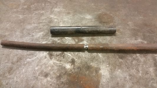

While beating my pry-bar back into shape, it snapped. YAY! I was already fixing it, so why not get some more practice. My fault for trying to coax hard iron to bend. I should have heated it, and then hit it with a hammer. Live and learn.
Step 6: Repeat the Previous Steps!
Bevel, pre-heat, align, and weld. Just like before. Only this time I could not get half the bar into my lathe. So I used the bench grinder to cut the bevel on one side.
This also meant I had to repeat the heating and cooling process. So while I had things warmed up I beat the waves out of the bar. And made sure the splint would fit by grinding the welds flush. With that all done I gave the bar another nap in the sand.

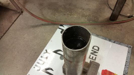

After quenching the pry-bar it should be hard, but brittle. Brittle pry-bars do not get to live very long. So I need a way to add some strength to the bar. To achieve this the bar needs to be heated to something like 800 degrees Fahrenheit. Or a dull purple-ish color. And quenched in oil.
The idea here is that the steel needs to be mellowed. By heating at a lower heat the crystalline structure will relax into a slightly more malleable state. By releasing stress from the hardening process. Then quenching it in oil will allow the steel to cool more slowly, but still quickly enough to retain stiffness. Stiff with a little flexibility does make a strong pry-bar.
I did hit a little wrinkle at this point. I was almost out of acetylene. And I did not want this project to lapse into another day so I improvised. I faked a forge together out of the weed burner, a large diameter pipe, and a couple of cinder blocks. This 'forge' does come with a "Don't try this at home," disclaimer. I was very surprised that the cinder blocks did not 'pop.' Cinder blocks are not rated for heat. And worse yet. The ones I found had been outside in the weather, frozen to the ground, before I put heat to them. Don't be a dummy like me, go get more acetylene.
So with my bomb of a forge I heated the pry-bar until I had the purple-ish color I was looking for. And then I quenched it in my home made oil-quenching tank which was a chunk of 2 1/2 inch exhaust tubing capped with some 11 gauge sheet metal. The oil I used was what I had drained out of my pick-up. I am pretty sure that engine oil is the wrong oil for this, but I used what I had on hand.

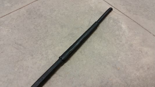

Step 11: The Final Product
Once the pry-bar was sufficiently cooled. I inspected my work. Originally I had thought that I would need to grind and smooth some sharp edges. Then sandblast and paint it. But I found the only happy accident of the project. By quenching the hot pry-bar in oil, it seems to have picked up a durable black coating. I ran a punch point over the surface and it did not easily surrender. So I deemed it worthy of being my finish coat.
