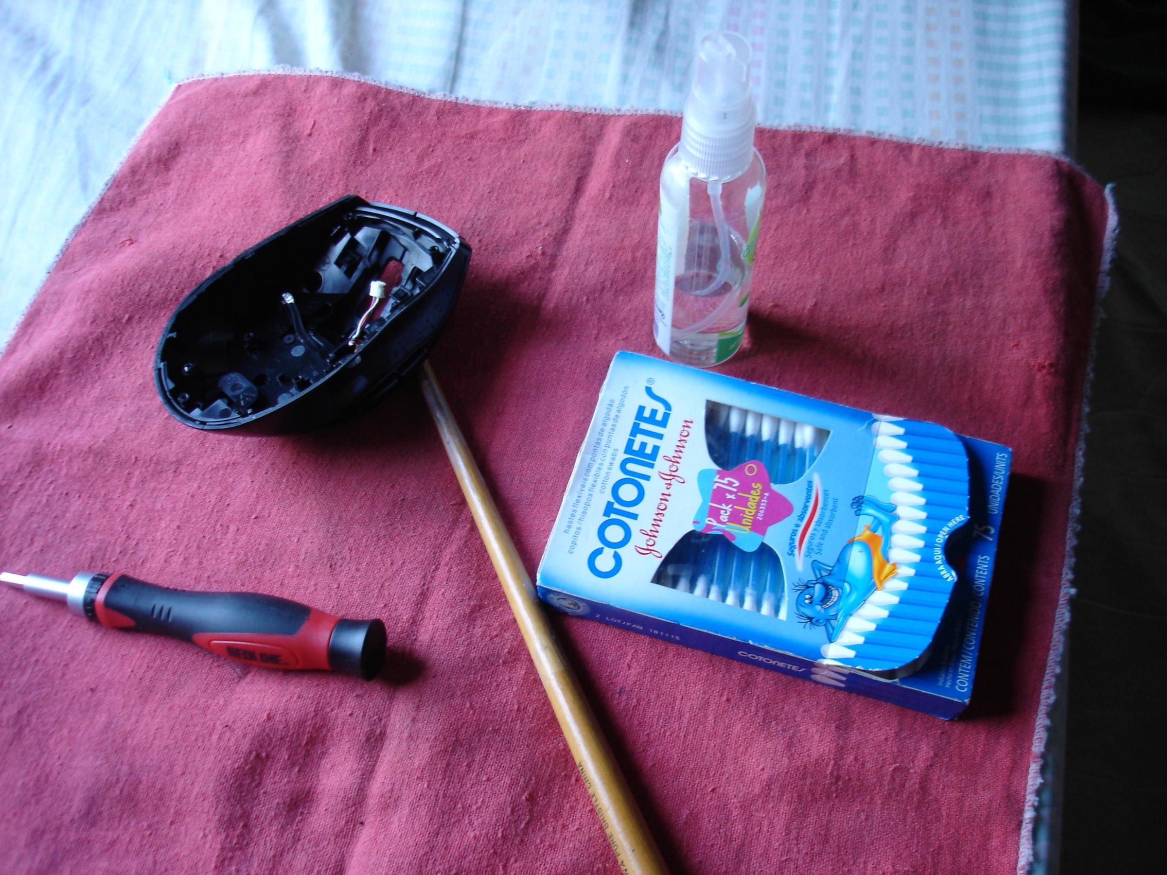

I have a Logitech wireless laser mouse and after a year or so of use, the left click button would double click every time I tried to single click something. As can be imagined, this gets frustrating very fast. So, being the tinkerer that I am, I decided to open her up and see if it could be repaired. Sure enough, It's a pretty simple fix, if you have some common tools and a teaspoon (edit:a tablespoon) of patience. There are some very small parts involved, so you will want to make sure you ware working in a well lit, clean environment so that any parts that are dropped can be easily found. I have now performed this fix for the third time and decided to take pictures this time to share with others who may find this useful. Each time the repair lasts about 6 months to a year before needing to be redone. I imagine at some point the piece causing the problem will break, at which time the mouse will need to be replaced (unless you're determined enough to try and source parts). Good luck with your repair, I hope this helps.

Step 1: Remove Batteries
If you are working on a wireless mouse, you will want to first open the battery cover, and remove the batteries from the mouse.
Step 2: Access Screws

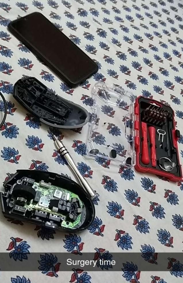

On this particular model there are four screws which hold the mouse body together. These screws are located underneath the slide pads on the underside of the mouse. To remove the slide pads, gently pry the edge of the pad up with a small flat head screwdriver and peel it off. They are held in place with some sort of adhesive.
Step 3: Remove Screws
Remove the four screws with a small philips head screw driver.

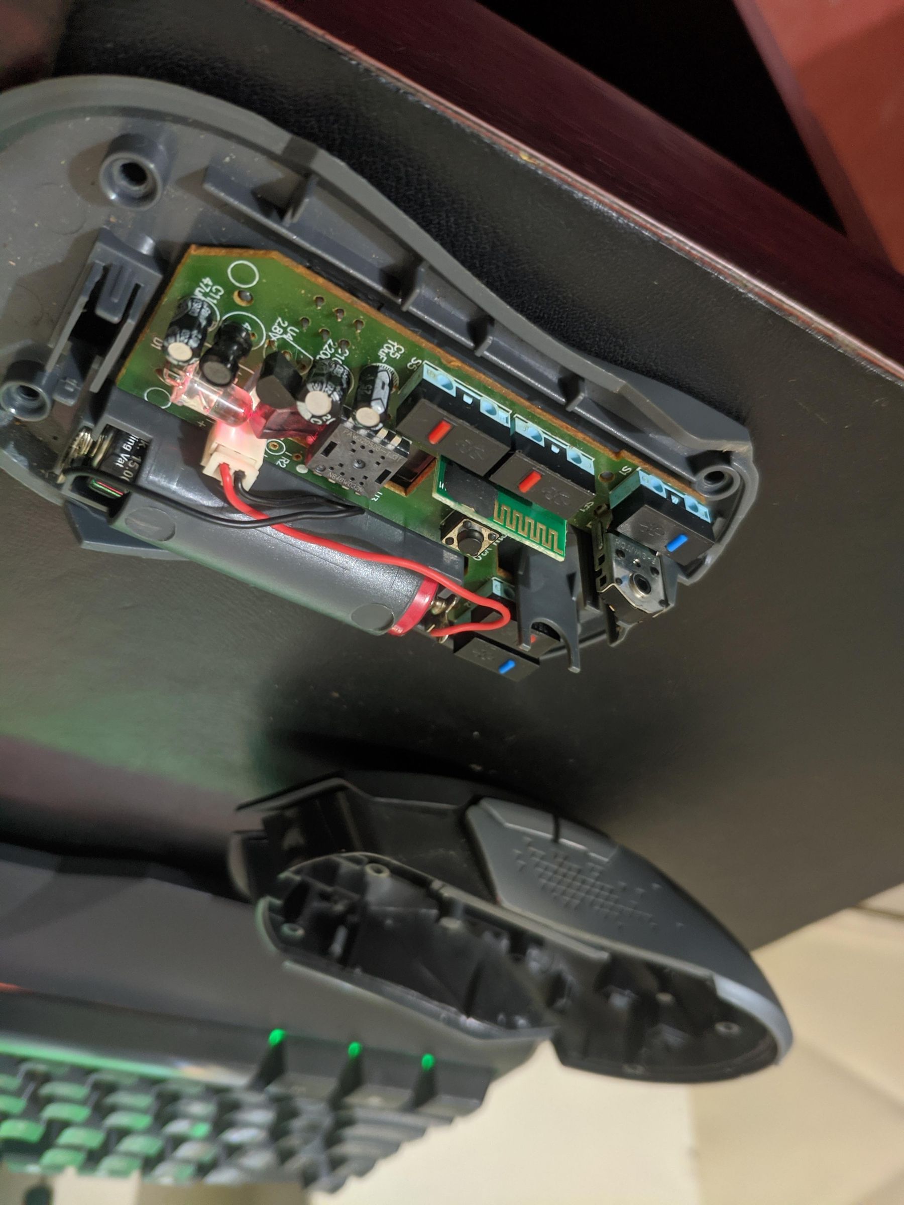

Step 4: Open Her Up
At this point the top cover should lift off, revealing the mouse's innards.
Step 5: Locate the Click Mechanism That Is Causing the Problem (usually Left Click)
Depending on the mouse, there can be one, or several click mechanisms. This particular mouse has 6, with the left and right click being the main mechanism. The left click is the one causing me problems, and is likely the one you are looking for also. Locate this mechanism so we can continue the repair.

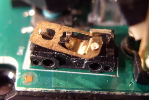

Step 7: Locate, Remove, and Retension the Spring
This is the key to the repair. You must remove the very tiny copper tension spring from inside the click mechanism.
After you have removed this part, make sure the small tab has a decent curve to it. You can see in the picture how I use the screw driver to bend the curve while holding it down with my finger.
Then bend the tab up, so there will be more tension on it after it is reinstalled. You can see the before and after pictures showing how this will look.
Step 8: Reinstall Tension Spring
This is where the patience comes into play.  This is probably the most tedious and time consuming part of the repair.
To reinstall the tension spring, first attach it to the small hook at the front of the mechanism, as shown in the picture. Then use the flat head screwdriver to push the curved tab into place while keeping the rear of the spring under the small arm at the rear of the mechanism. The second picture shows what it should look like after being reinstalled. Notice the arrows pointing to the spots that need the most attention. You want all three to be correct or the mechanism will not operate properly.

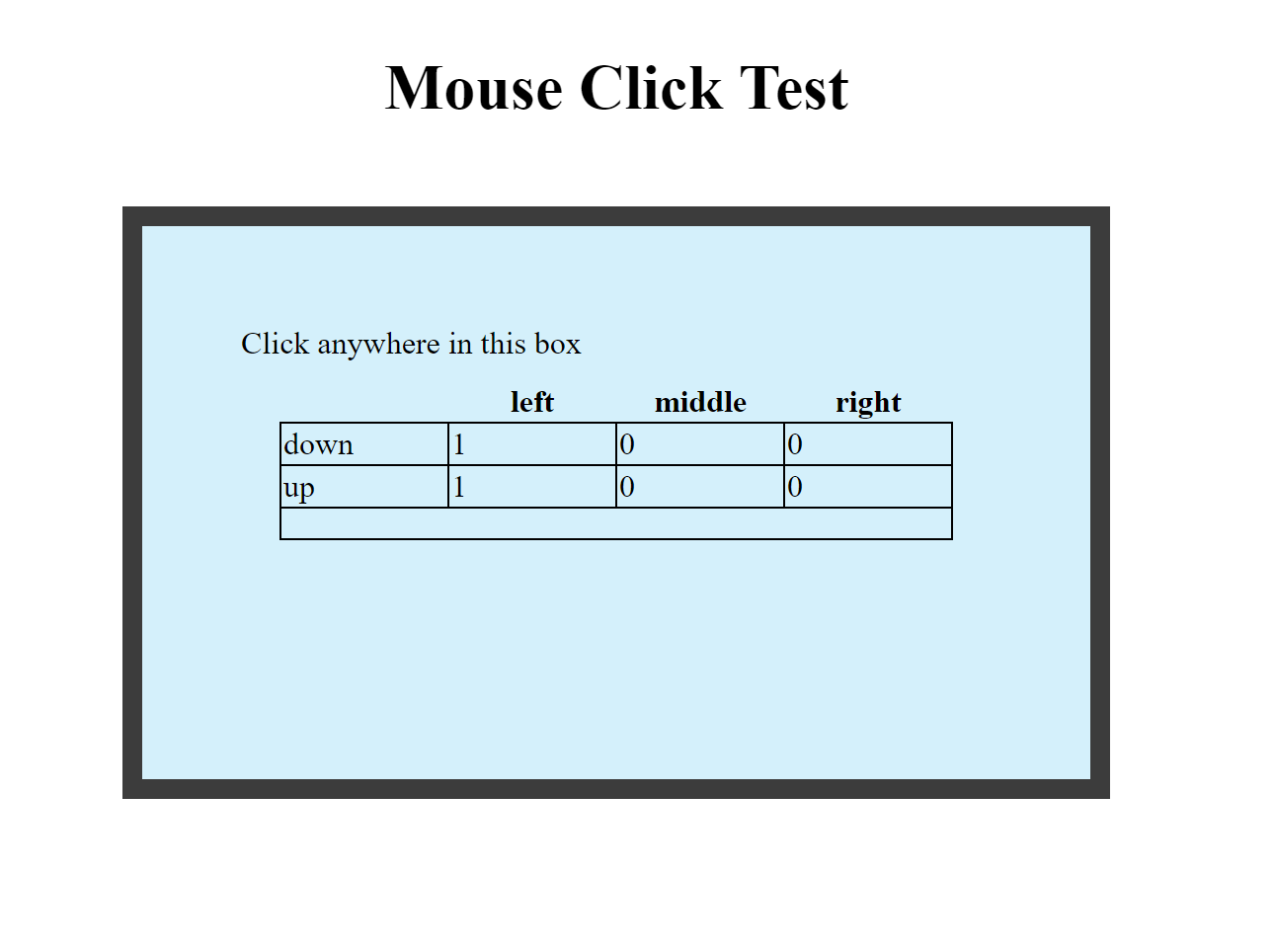

And on this site you can check whether your mouse is cursed by the "fast double click" plague: https://codepen.io/blink172/pen/vERyxK

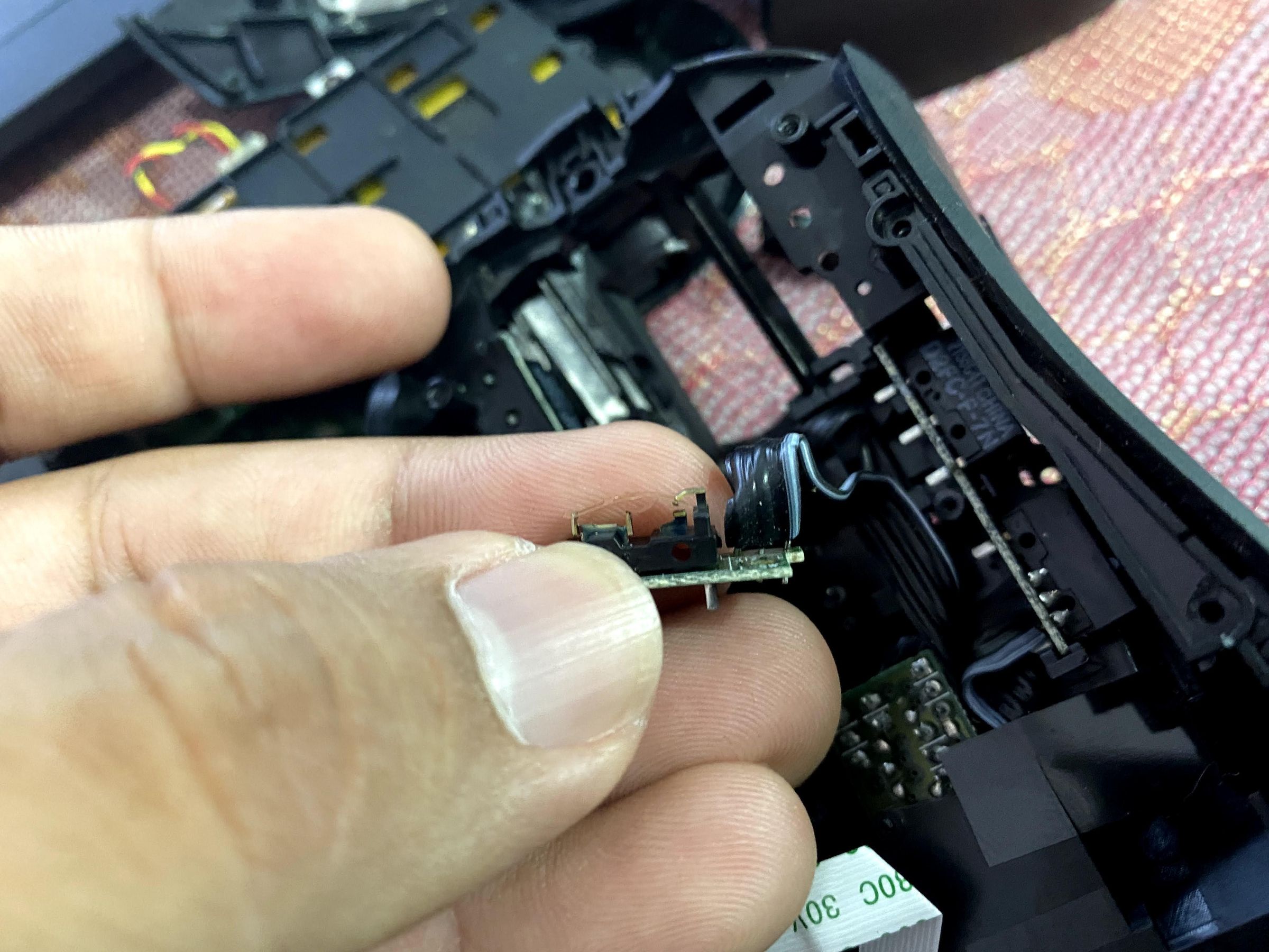

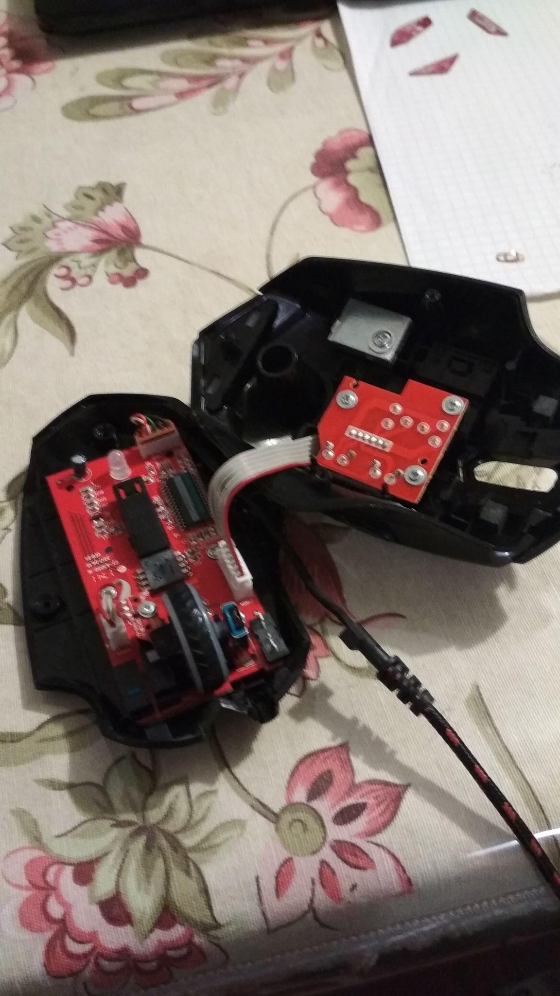

tedious!! was able to do a more reverse entry with the spring on the last part, definitely need patience, but now know how to do it, had to take the right click assembly apart to see how it should look. Did this on a logitech g400s (purchased new at 48$ 7 years ago, people trying to sell refurbished ones for twice that now.)
