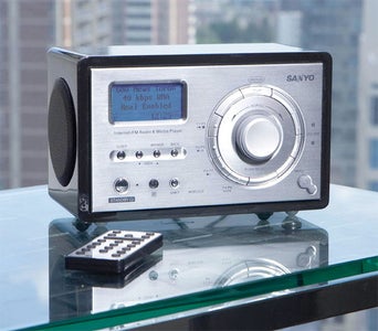

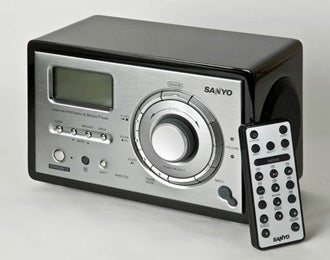

The Japanese company "Sanyo" is producing a digital radio model R227, which looks exactly like the "Medion"'s one. (see the pictures). This could be some explanation about the missing circuit diagram and the secrecy. I have contacted "Sanyo" support, asking them for their schematics, having in mind, that practically this is the same product. For me seems unbelievable, that if the external view of a device is fully identical with another one, something internally could be different. May be only the software....The "Sanyo" support, or what is remaining now from it ("Sanyo" was acquired by "Panasonic"), did not answer. I understand them - now they have other problems.
