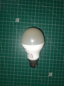

Hi guys, I am working in my lab room, and suddenly with a small explosion, my room light turned off. This one is 5 watts Orient company LED light. This one has been working well for two years.

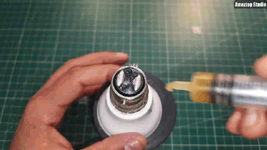

Step 2: Opening Method

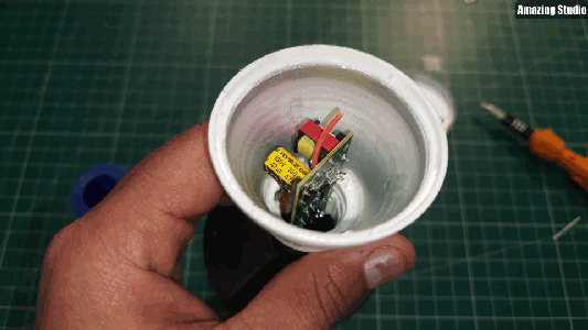

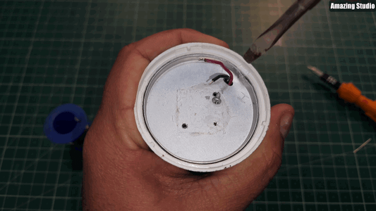

To expose the circuit, we have to open the outer cover(diffuser). This helps to diffuse the light equally in all regions of the room. We can remove this cover by hitting a little bit with a hand or a small hammer. Don’t hit too much or hard because this may damage the circuitry

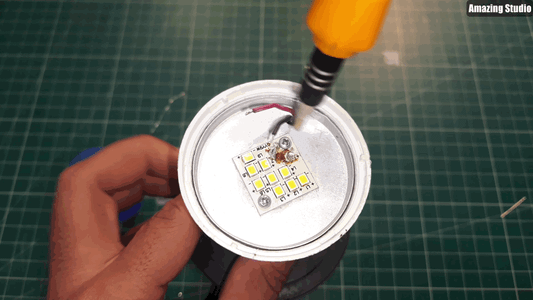

Step 3: Exposing Circuitry:
After this, with the help of a screwdriver, unscrew these small nuts from the led PCB. Screws are given to make better contact with aluminum so that PCB will not overheat or burn out. Then desolder the positive and negative wires from the main PCB. Remove the standard aluminum plate with the help of a small screwdriver and hammer.

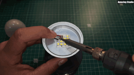

Step 4: De-soldering and Soldering:
Remove the excess solder from overhead to get the wires out of the white shield. You can use desoldering pump or wick method to remove excess solder.

De-soldering may take some time; due to log time oxidation, solder joints become very dry; try to remove it with an excess flux and a high-power solder iron, with 400*C.
Because everything is designed of aluminum to keep the led PCB cool, it may be hand for you to make a better solder joint with a low power soldering iron. So, keep the temperature above 400*C.

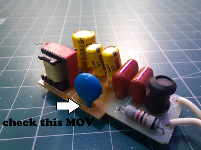

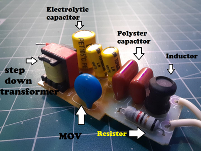

Step 6: Driver Pcb:
The driver PCB has different components- Transformer, MOV, diodes, resistors, capacitors (electrolytic and polyester), Inductor, a bridge rectifier, and a constant current regulator.
Step 7: Circuit Detail:

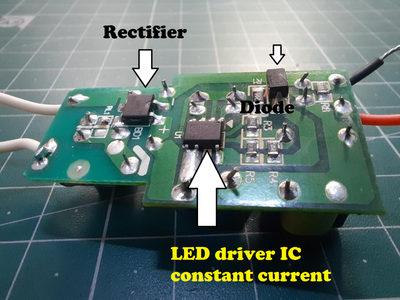

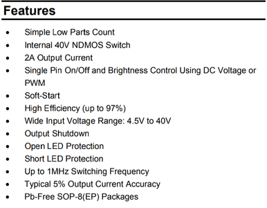

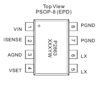

All the Led’s in PCB are joined in series; to power on the Led, we need at least 40volts. In driver PCB, there is a transformer in the circuit to step down the voltage. 3 electrolytic capacitors, 2 polyester film capacitors, one 7mh Inductor, and a 170 ohms resistor. Driver stage has doubled layer PCB, so SMD components are mounted on one side and through-hole components on another side. At the bottom layer, there is a Schottky diode, 0.5A rectifier, and a led constant current driver IC (bp2863). See datasheet from here.

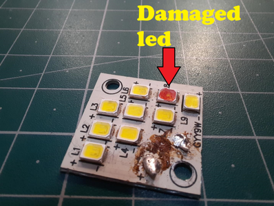

Step 8: Troubleshooting: Case 1:
Check the voltage value across the end of the driver stage. If this is more than 30 volts, then okay otherwise, we have to repair this.
Step 9: Case 2:

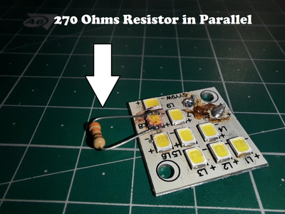

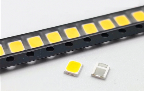

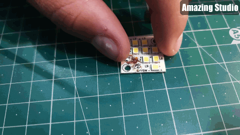

check the Led’s one by one, keeping the multimeter in continuity mode. If all are turning on, then okay otherwise, we have to change any specific or all of them.
Step 10: Case 3:
If only one Led is not working, then we have to remove this Led; either we can place a similar new one or a resistor of 0.5 watts 270 ohms.

  1. Keep in mind all the small Led’s on Pcb are joined in series. If any one of them is damaged or blown up, the whole system stops working. In 75% of cases, this is the only problem that can be solved by placing the same value resistor or replacing the led with a new one.

  3. In 15% cases, there may be a fault in MOV (metal oxide varistor) or electrolytic capacitor. If found faulty, you can first check them, then replace them with a new one of the same value.
