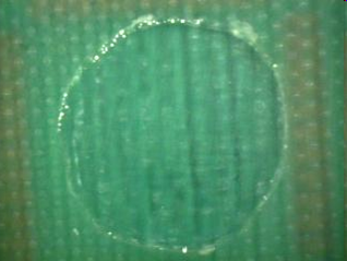

Step 3: Damaged Bulk Laminate Area

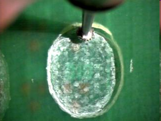

Remove the burned PCB areas by using a Dremel or Micro drill rework system. Use a ball mill to remove down to the same level all of the damaged or burned laminate material.

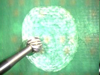

Step 4: Smooth Out the Sidewalls Using the Dremel Tool and Smaller Ball Mill
Use a smaller ball mill to “smooth out" the side walls.

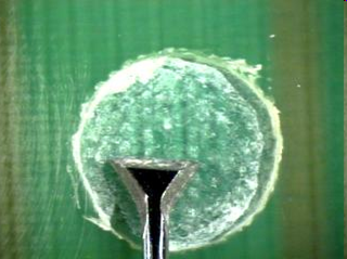

Step 5: Flatten Out the Bottom Surface of the Well Created in the Previous Step
Use a specialty medical scraper to "flatten out" bottom surface of the well created by the tool.

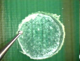

Step 6: Undercut Around the Edges of the Site
Use a small thin ball mill to provide an undercut around the periphery of the excavated site
