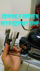

Using my tool set for air conditioning, I cut a length of spare tubing and expanded it. I basically used it as a splice and soldered the whole thing together.
