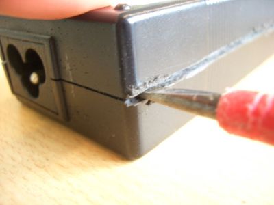

Step 2: Opening the Case
The IBM AC-Adapter is not meant to be opened. The case is made of two plastic frames pressed together and melted at the contact to one piece. To take it apart you need to cut the two halfes using a Dremel tool and a cutting disc.
WAIT SOME MINUTES AFTER PULLING THE POWER CHORD FOR THE CAPACITORS INSIDE THE ADAPTER TO DISCHARGE!
Cut with the disc along the sides of the case.
Be careful not to cut too deep. There is a shielding case underneath the plastic case that covers the electronics. If you see the metal in the cut, you are a little too deep ...
Cutting through the metal frame can damage electronic parts.
Only cut the two long sides. The sides containing the power plugs need not be cut .. we will break them open.
Take the blade screwdriver and put it in the cut you made. Place it on the edges of the case, because these are the robustest points of the case. Twist the screw driver to spread the case apart. The uncut parts of the case will break now. Do the same to the other corners of the case.
Take the plastic parts from the inner electronics. Now you can see the metal shielding. On the picture you can see that the shielding got some marks ... but it is not cut and it still works well.
Now you can remove the shielding and the underlying insulation to get access to the electronics
