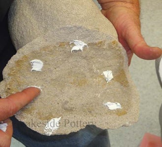

Step 1: Drill Holes Using Carbide Tipped Bit
This statue is about 3 feet tall and about 70 lbs. Remove loose fragments or old glue.
The selection of drilling location needs to be in the center of stone mass on both parts, the head and the body.

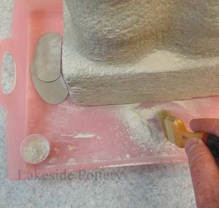

The drilled stone dust is saved for later to be used to fill in the large gaps between the two parts once cemented.

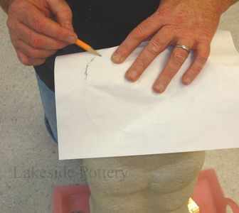

Step 2: Drilling Holes on the Other Broken Part Matching Location and Angle
Once you have drilled the holes on one side of the broken sculpture, how do you match the holes in the other side? Place a paper over the drilled surface, glue it down with water soluble glue (tape did not work in this example - it did not adhere to the soft stone surfaces) and outline the hole and the edges of the stone. Then, poke holes through the paper marking drilled holes. Follow the steps below and mark the exact hole location on the other portion of the sculpture (head) for accurate alignment location transfer.
Note that the epoxy, once cured, is much harder than the stone in this case. Therefore, drilling the holes wider will not create weakness. Wider holes will ease the fit requiring less accurate holes alignment.
Step 3: Accuratly Drilling Holes on Other Side
Mark with pencil the holes location on the other broken piece and verify marking. Drill the matching holes on the other broken piece

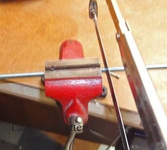

Step 4: Cleaning and Cutting Metal Rod
Remove dust from holes and clean surfaces well. Cut metal rod to the correct size (need at least 3")
Step 5: Assembling Sculpture and Rods and Mending
Cut rod to size (in this case about 4-1/2"). Place in holes and verify alignment.

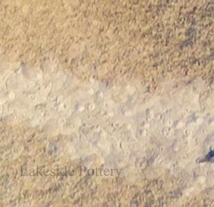

Step 6: Filling Gaps and Cracks
Once clear epoxy is cured, mix the filler epoxy with the stone dust you have saved (about 30% dust and 70% epoxy) and fill all the gaps. In this case, we used the PC-11 (where to get PC-11 filler) slow cure filler epoxy. Wait 24 hours before handling.
Step 7:
Once filler is cured, grind, drill, poke, and scratch surface to duplicate the rest of the sculpture surface texture
