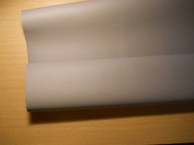

Step 5: Cut Vinyl
I decided to use a piece of vinyl that matched my car's interior, a light grey. But of course any material can be used; scrap leather denim, or your favorite old sweatshirt. But keep in mind that this piece will get a lot of wear, and vinyl is very easy to clean (and cheap! I paid about US$4 dollars for a half yard at a fabric store).
