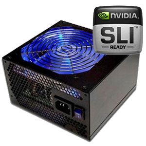

Step 1: Power Supply!
If you plug in your computer and hit the power button and nothing at all happens (no fans or lights come on) CHECK THE FUSE IN THE PLUG.
Only open a computer up if you Know the fuse in the plug is working.
Power supply problems:
1.The light or fan on the power supply do not work.
2.Nothing in the computer works.(plug something into the USB power to see if there is power going to it)
3.No lights / fans or beeps come from the computer.
If any of the above happen to you try changing the power supply unit.This can be down by removing the computer case and removing the PSU(picture below. The PSU is only held by a few screws.
Put a new power supply unit in and try that and the computer should work.

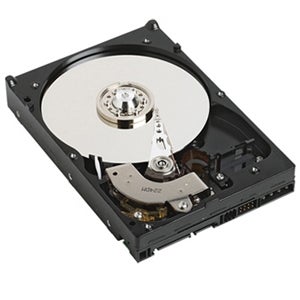

Step 4: System Disk Failure (new Hard Drive Needed)
If you alreasy tried step 2 and your computer still says SYSTEM DISK FAILURE, then you most likley need a new hard drive.
WARNING !! REPLACING A HARD DISK WILL BE LIKE HAVING A NEW COMPUTER, ALL THE INFORMATION THAT WAS ON THE COMPUTER WILL BE ON THE OLD HARD DRIVE AND NOT THE NEW ONE.!!
Replacing a hard drive is simple. first open your computer and look below the dvd and cd drives for the hard drive.(picture below)
Now take the cables from the back of the hard drive. and check to see if it is an IDE or SATA hard drive.
The hard drives in the picture below are SATA , the SATA cable is the red cable connecting to the hard drive from the mother board.
An IDE cable is the ones connecting the DVD/CD drive to the mother board. these can be used on hard drives too so check before you buy a new hard drive.
remember
SATA: small cablecorrupt
IDE: Thick cable with about 24 pins on each end (the ends are long rectangles)
After removing the hard dive bring it to a computer shop and ask them for another hard drive the same or the hard drive you want.
You can buy a 80GB 7200RPM Maxtor hard drive for £30.
To fit the hard drive insert it into the pace below the disk drives and secure it with 4 screws and then put the IDE or SATA cables into it. then insert the power cable.
Turn on the computer and reinstall your operating system by using the disk you got with your computer.
Now your computer is fine .
