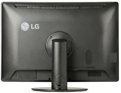

This particular monitor is an LG W3000H, so while this is specifically geared towards that, it might give you a general idea of how to approach a different monitor which is also having this problem.

This monitor has been my main screen for a long time. Maybe 10 years or so. Early last week I turned it on and it looked like the dramatically-recreated picture above. Almost completely dark, though still identifiable to the computer as being there and "on." It also sounded like a summer evening in upstate New York - the buzzing of a thousand bugs in a nearby field wafted through my office, which is in Los Angeles, so bugs are mostly illegal and not something you hear 'round these parts. Turns out it was the capacitors on the... I'm going to call it the LED driver board. It probably has a proper name, but... me mechanical guy.

There are two screws on the back of the monitor towards the bottom (see picture). Unscrew them, then carefully begin to pry apart the front and back of the monitor. I used a number of tools, but the winner was a stiff putty knife and a butter knife. If you go that route, make sure you don't shove it too deeply inside, since there's electronics in there and you might break something. Be gentle. Also maybe use a clean butter knife or you'll get butter everywhere.
