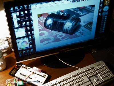

It looks like plastic mines are almost depleted nowadays. The bigger and heavier a display is, the smaller and thinner is its stand. And the 23” Samsung monitor has shared the dandelion’s fate. Occasionally I’ve found the method to repair plastic breaks with baking soda. The process of display stand repair is under cut.

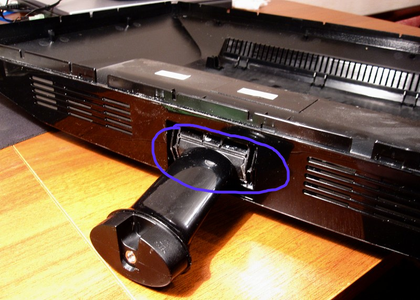

Inner hub (allowing horizontal inclination) was broken in the place of its attachment to the stand. I don’t know the engineers’ idea behind, but 2 screws were holding 15 pounds of display.

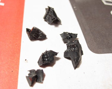

Totally ripped out! We need either a donor part or immobilize it or grind something out somehow. Epoxy is not an option for plastic.
Throwing the fragments away, since there will be no use of them. Covering the damaged places with soda.
Now I add enough volume of cyanoacrylate or Super Glue to moisture all the soda.
UPD It should be classic liquid glue, not a gel. Polymerization goes instantly, mixture stiffens in a couple of seconds.
Resulting “swatch” is very firm, it is harder to grind it out than original plastic. How we need to burnish it and drill screw holes.
That’s it!
