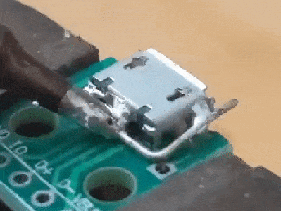

We need to identify the joints that need heating to remove the port, and plan the wire route that will channel heat and melt them all at once:
  1. Most SMD USB ports will have 2-4 mechanical joints either side of their main body (and in this case a joint underneath), as well as several data pins.
  2. Try to work out a path to join all these spots that need heat with a small piece of wire, in this case by bending a C shape.
note: Pads underneath the main body of the connector will melt if spots nearby are heated, but may make the process take longer.

Step 3: Tinning Joints and Attaching the Wire
  1. Add a liberal amount of solder to all the joints.
  2. Slide the wire into place.
  3. Join the wire to each blob of solder.
note: Don't worry about making neat joints or bridging pins! this will all be gone soon.
Step 4: Removing the Port
Apply gentle pressure to the connector, pushing towards the edge of the board until the connector slides off.
If your connector has through hole mechanical pins, or plastic locator pins that extend all the way through the pcb, tweezers may be needed to pull upwards instead of pushing with the iron.
note: This took about 7 seconds for me, with my iron running on a 30W USB-C PD power-bank, which is not optimal, it should be much faster using a higher wattage iron, or higher wattage settings if supported.
